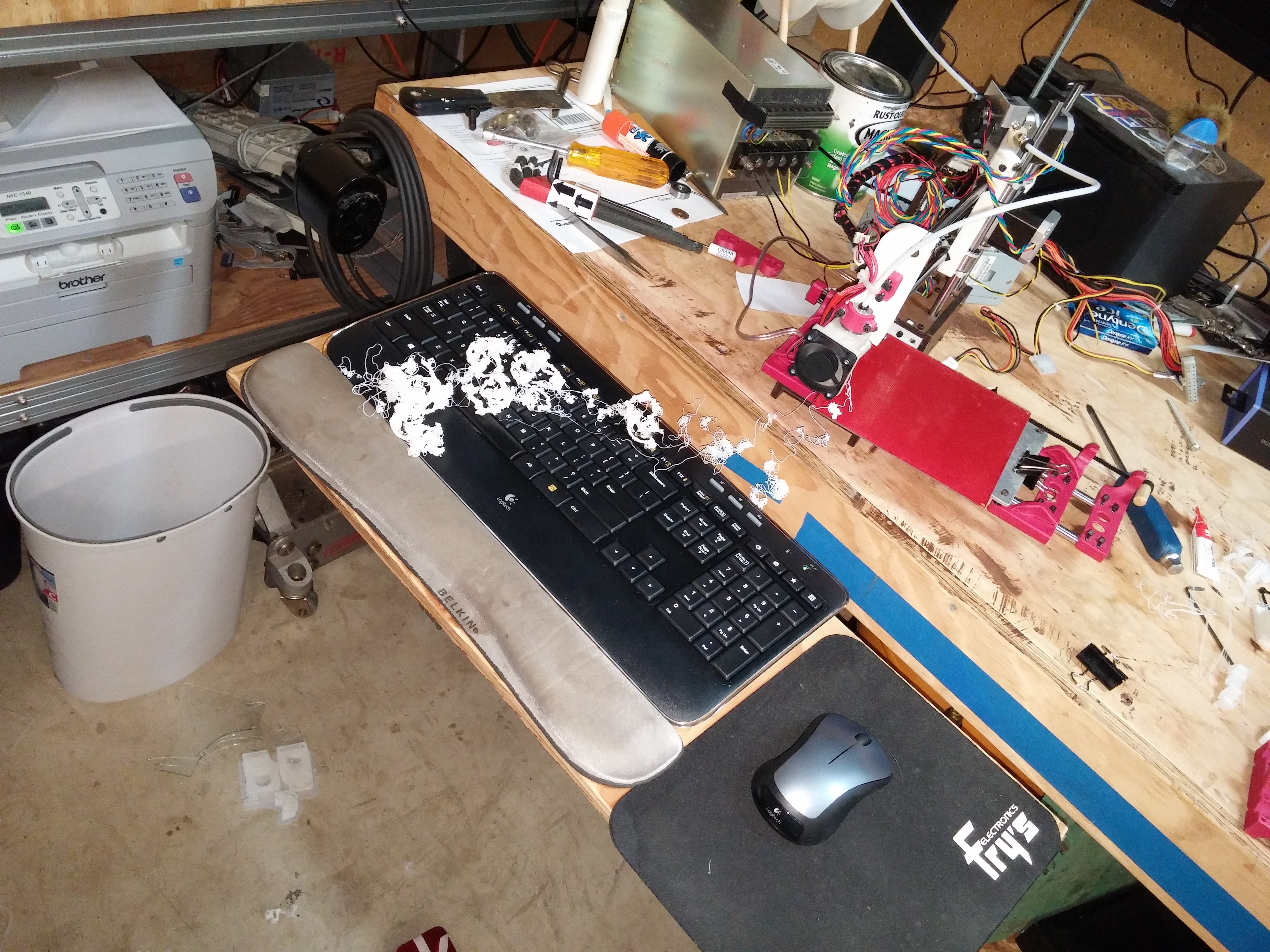

Woke up this morning to my glass bed broken on the floor and a
Woke up this morning to my glass bed broken on the floor and a pile of fresh spaghetti… But at least I dont have to fix anything!

BTW, did you figure out root cause? Was it the binder clips slipping off due to vibration? Z axis off causing head crash?
Looks like I’m using the same X-axis upgrade as you. I have my glass bed stuck to a thin sheet of plywood with double sided tape - the plywood is screwed with lift/leveling springs to the printed brackets much like your setup.
How big is (was) your print area and do you have any issues with wobble/vibrations along the x-axis due to the inertia of all that mass?

@Alex_Wiebe , it looks like a corner curled up and the hotend snagged on it. I’ll have to wait until I get home to finish investigation.
I doubt you have this exact same Y axis mod, since I designed it and haven’t really posted about it. It’s based on the printable 1401 Simple mods by Jon Lawrence. I flipped the Y rods to between the Z lead-screw/rods and it can only do bowden hotends. If you’d like to give it a go the source is here: https://github.com/MechanizedMedic/PBsimple_YZ_mod
@Brook_Drumm , IMO the immediate solution for making our heating loops more robust is to convert to thermocouples and use replaceable fuses for these outputs.
I was looking at your Y axis upgrade - very cool with the bowden setup.
I was however talking about your X axis and specifically wondering if the binder clips maybe weren’t as robust/secure as planned.
@Alex_Wiebe You are correct! The clips were not in good shape and I had some bogus settings after upgrading Cura. I’ve reworked them and started a new print. I’ll get to see how it turns out when I wake up in the morning.
