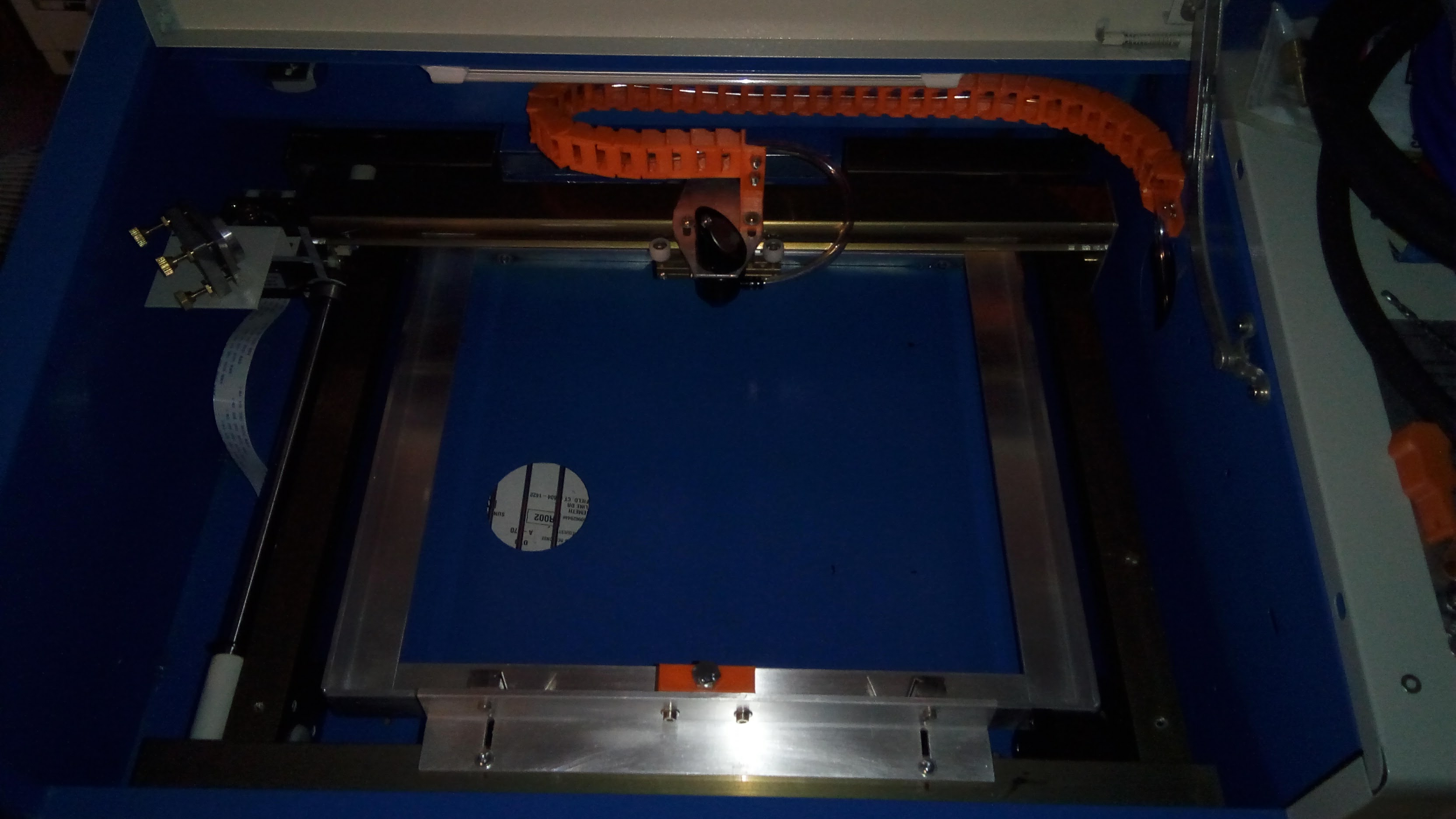

Cement sounds good. I’m using my own bed design. It’s mostly open so I want to put something in the bottom of the machine.
Can you add a photo of your bed and tell me how far it is away from metal below it?
You can see in the first picture the hole in the bottom of the machine. I covered all the holes with aluminum duct tape but of course that reflects a lot of the light. I think I will try 1/4" cement board in the bottom. Also may try some in the frame too.

Just thinking more about it and thought I saw someone use ceramic tile upside-down. I have some around that I could try.

the hole at the bottom is an air input, needed if you want a good air circulation & exhaust.
also handy for cleaning the ashes and bits away.
The hole also let’s the laser light burn anything that sits under it. I just let more air in the front. Almost set a box of plywood on fire because of that hole.
