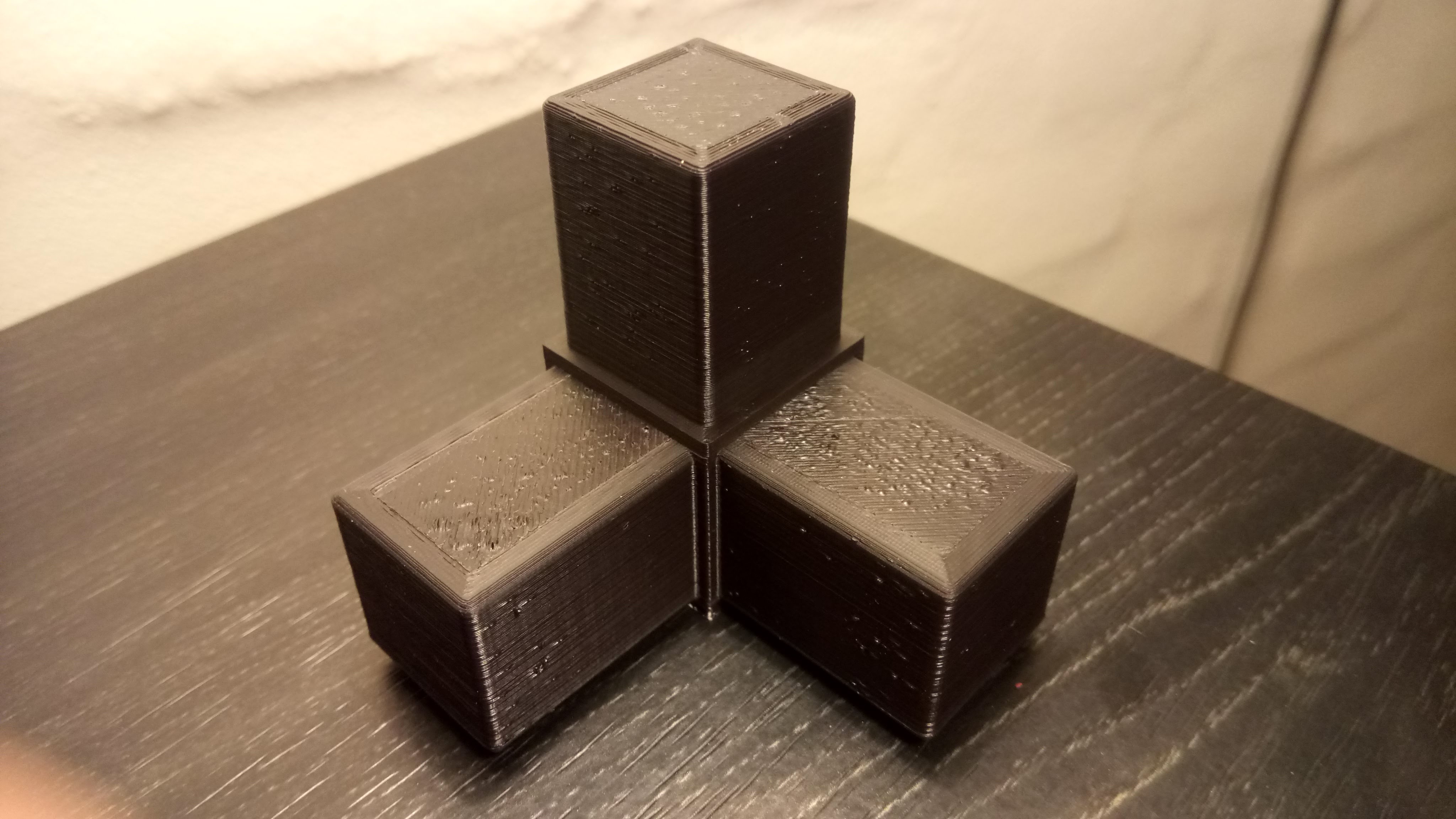

Here is an example of the support surface quality I get on my parts. The back side you see in the pictures is all support material surface.
Supported surfaces can be quite smooth even with breakaway supports.
