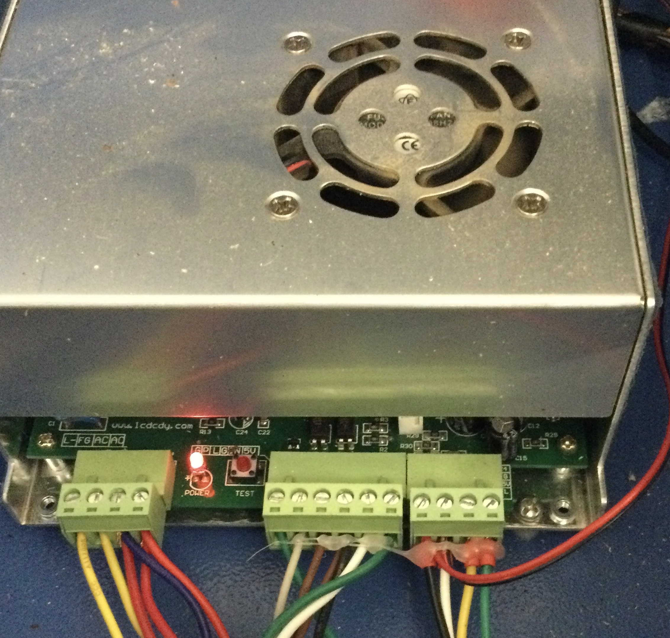

Post pictures of:
Control panel
Laser power supply (LPS) showing the connectors

Thanks for feedback. Think I’ll return the tube. W.r.t. the power supply, it shows a power light and the fan and accessory power is present. I’ve tested connectivity and resistance through laser switch, test switch and potentiometer and they all seem fine. However, trying to fire the laser with the cover test switch or the PCB test switch (inc. bypassing safety breaker on the cover) does not even twitch the ammeter. Haven’t opened it yet to check for burns or blown fuse - I was gonna be sensible and wait for any latent charge to dissipate
More than happy to try any other tests that are possible without a tube in place.
Thanks.
If it doe not fire with the PB down on the LPS then it is suspect.
What does the IN pin on the 6-pin connector read with power on?
It should be >0 and vary with the pot.
Does vary, ranging from just over 0 to nearly 5.
There is not much else to test “safely” so I would continue down the tube replacement route.
