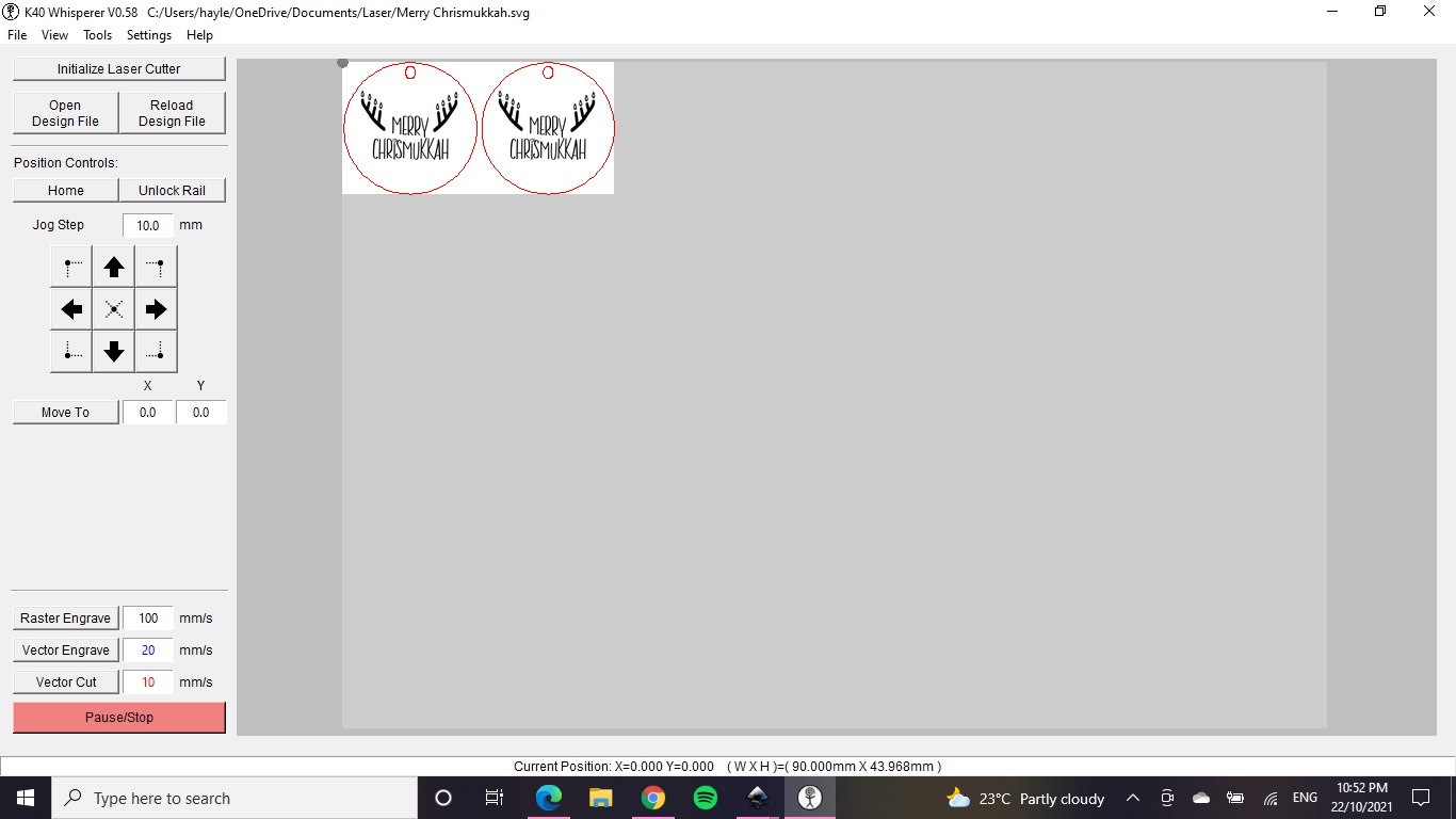

I’ve create simple designs (circle with words) in Inkscape and everything is fine. Once I open the design in K40 whisperer, the vector cut line is all wonky, unlike the smooth line in inkscape.
Any suggestions how to ensure it stays smooth in the image when opened in k40 whisperer?
Thanks

That’s how it looks in inkscape. but in K40…

K40 Whisperer’s preview renders SVGs without antialiasing (vector cut/engrave lines are also always displayed with a width of 1 on-screen pixel). This doesn’t affect the actual geometry of the paths. They will look just fine when you cut/engrave them.
Thank-you. I don’t quite understand what that means, however when it cuts the lines are wonky

Basically, seeing those jagged lines in K40 Whisperer is perfectly normal. That’s just how it renders the path data for the preview.

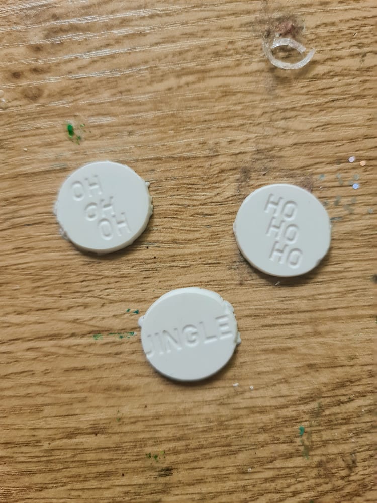

What kind of material is this? It kinda looks like it was smoothly cut, but the edges melted and solidified unevenly.
Try wood, acrylic, or cardboard.
The middle “OH” looks funny on the left one. Perhaps there is a mechanical issue?
I know. It did some weird shift to the side on all of the cuts I did in that section.
It’s 3mm acrylic.
I feel I has something to do with the program. I’ll have to see ifnit needs an upgrade or reinstall it.

My partner pulled it all apart and found there was something behind the glass on the mirror which was impacting the cut and making it wonky.
Took it out and it cut super smooth.
Now its just spluttering a bit and dieing through the cut then starting up again after a second
