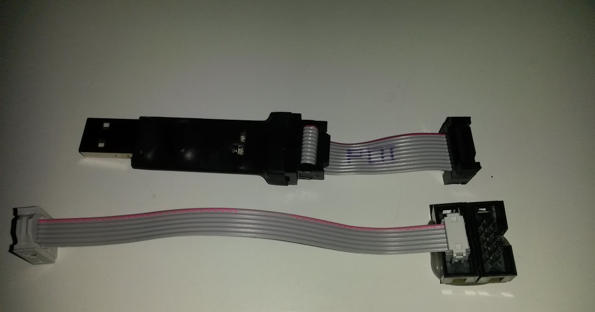

You can use a 2.50$ usbasp with patched firmware.I programmed my DIY TinyG board exactly with that.
