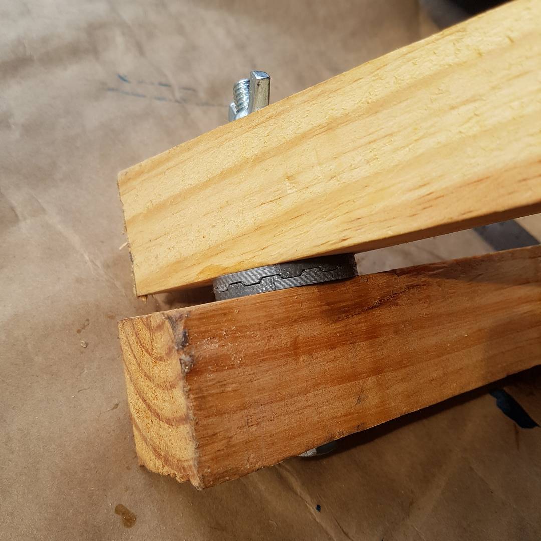

If pins engage wood to prevent turning (as I expect) and this part works well, casting in aluminum would make for very strong joins.
@Fred_U ​ At the moment it seems to hold very well, still some testing needed.
I’m looking into how I can hold them in place without a bolt
I can’t imagine how one could secure such a joint without a bolt or similar mechanical fastener. An important factor to consider is the forces applied to the wood after the joint is assembled.
I can picture a set of mating squared off U-shapes in the radial pattern. One places the pieces together and rotates the parts to engage the U-shapes, but that means that only forces in the correct rotation are to be applied once connected.
I didn’t put too much work into the drawing, as it should have the two disks (shown in side view below) coaxial and the U-shaped clip portion aligned and ready to engage. Tricky to 3D print, though, especially as the individual clips would have to be pie-shaped/radial just as your engagement teeth are.
I was thinking something like an elastic band. My current onbjective would not need to support much weight.

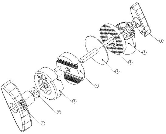

Coming from the film industry. A gobo arm has a similar grip but with added rubber washer in between the teeth. When tightened, you can’t budge it at all. So more smaller teeth and a hard rubber washer is all you really need.
https://www.bhphotovideo.com/c/product/216685-REG/Matthews_B350580_Hollywood_Head_Black.html
And trust me this hold an enormous amount of weight out on an arm dangling over an actor’s head.
But build it and tighten it, so that the weight of the arm tightens the lock and doesn’t loosen it. You’ll see what I mean if you turn it around and apply pressure, you will either be making the lock stronger or weaker.

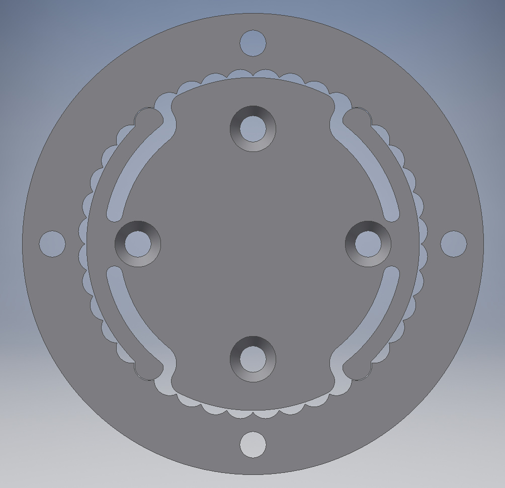

@Ariel_Yahni_UniKpty , this was something I made a while back for something that needed a “ratchet” feeling. Not sure if it would work for you, but depending on your weight requirements, making the spring loaded “pins” thicker so it’s harder to rotate might work. Or come up with a way to loosen the tension, rotate, then tighten it up again. I’ve been meaning to revisit this. I had the idea of using a bolt that goes through and adjusts the inner tension of the springs but at that point, just put a nut on the other side of that bolt and tighten it. :slight_smile:

Ah, that may not work. I don’t know how well the pins would work with wood. For me, I originally designed that for a cryptowheel. It has characters on the outer ring. Stack multiple of them together and you get something like a combination lock and each ring “clicks” are you rotate it.
