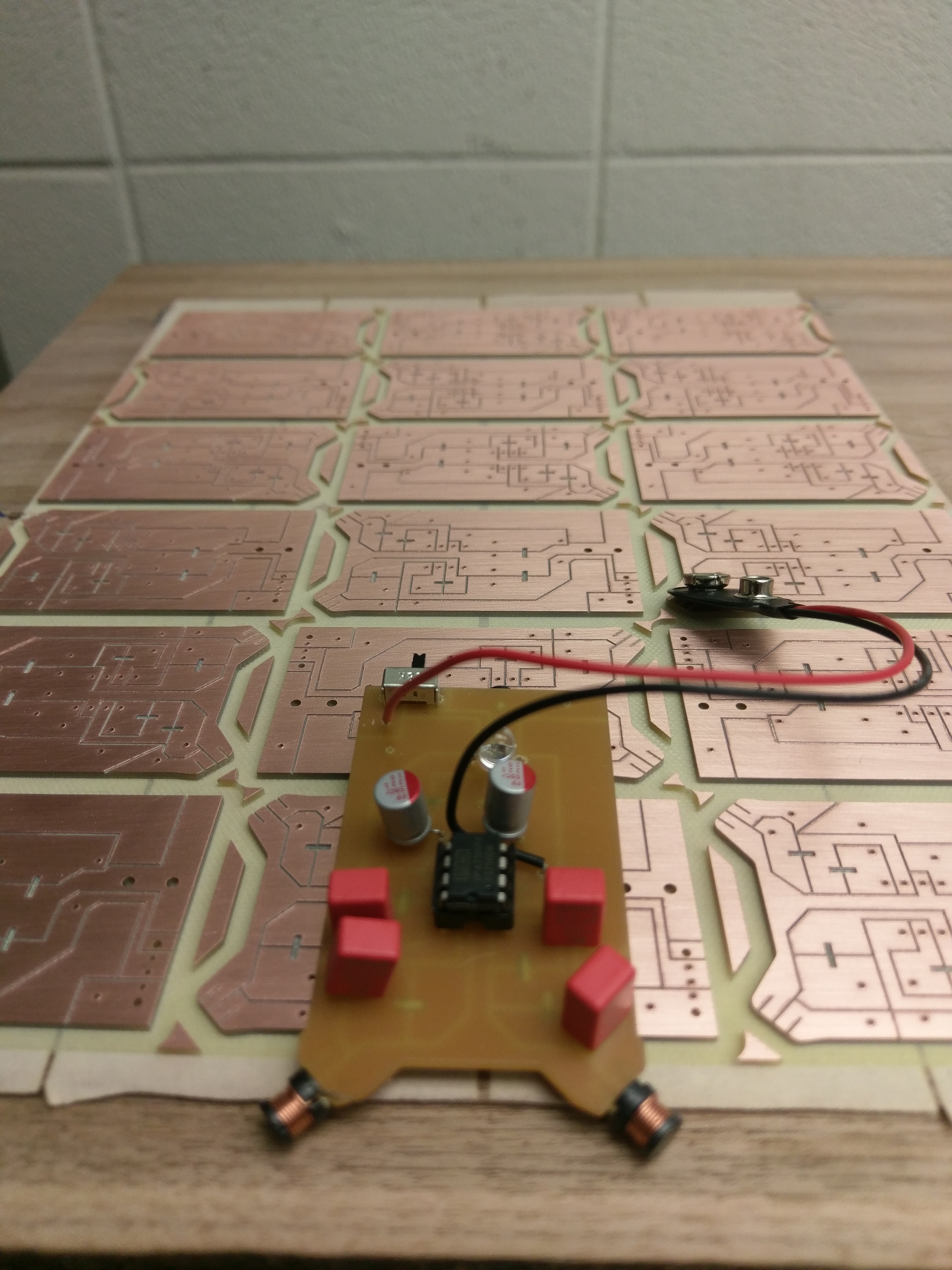

That my friends is a soldered circuit board for the EMWaveEar. It is sitting on 18 circuits boards that I finished milling today.
So WTF does it do?
It let’s you listen to em waves that are all around us. You wouldn’t believe how noisy a auto engine compartment is.
Uh oh, if that thing gets popular, people might realize how atrociously repraps radiate EMR…
Ah. Now after re-reading the original post, it makes sense.
So does it convert to audio range or just voltage signal out for CRO or similar?

@raykholo ​ I was in the 2nd building. I was so busy Saturday I missed most of the show. Had fun with the kids, watching their faces light up when they heard the music playing out of my mini boom box, that had the speakers torn out. It still had the voice coils of the speakers and that is what the em ear picked up on.
