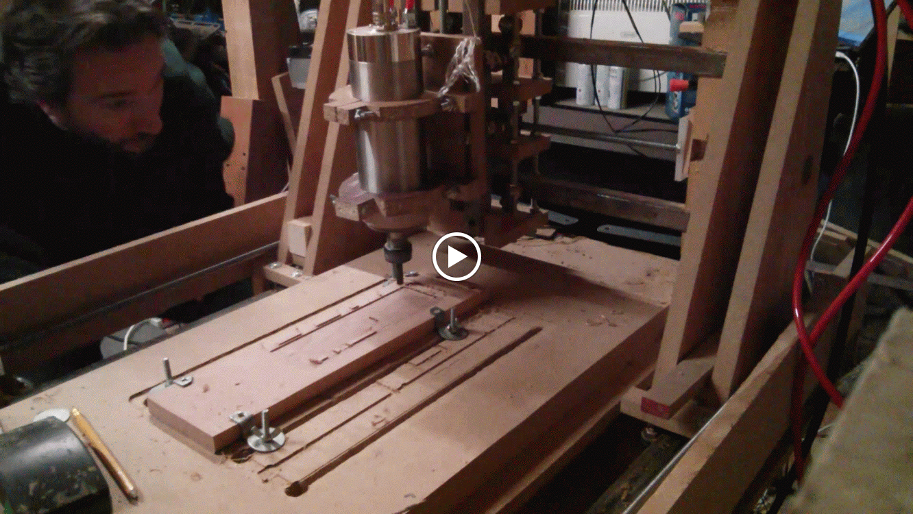

I bought a pair of CPU heatsink/fan combos which I lashed onto the y and z axis steppers. They had been getting alarmingly hot, but these babies kept them both cool to touch throughout about 2 hours of operation.
The machine ran perfectly. Unfortunately operator error meant things didn’t go as well as they could. The intention was to mill a raspberry pi case in two passes, one rough with 1mm clearance with a big 10mm router bit. then follow up with a finishing pass with a 3mm bit.
Unfortunately I miss calculated the depth of wood. I thought I’d be left with a mm or two all around holding the piece to the main block after the rough pass, but it actually just about perfectly cut clean through releasing the pieces before I could do a finishing pass. Doh.
Also there was a big in the model which generated bad gcode such that one side of the bottom got cut away when it should not.
Despite these failings, the machine itself rocked! And I finished by making myself a little sign which I’ve tried cutting before. Last time it didn’t come out to well. This time it looks great.
