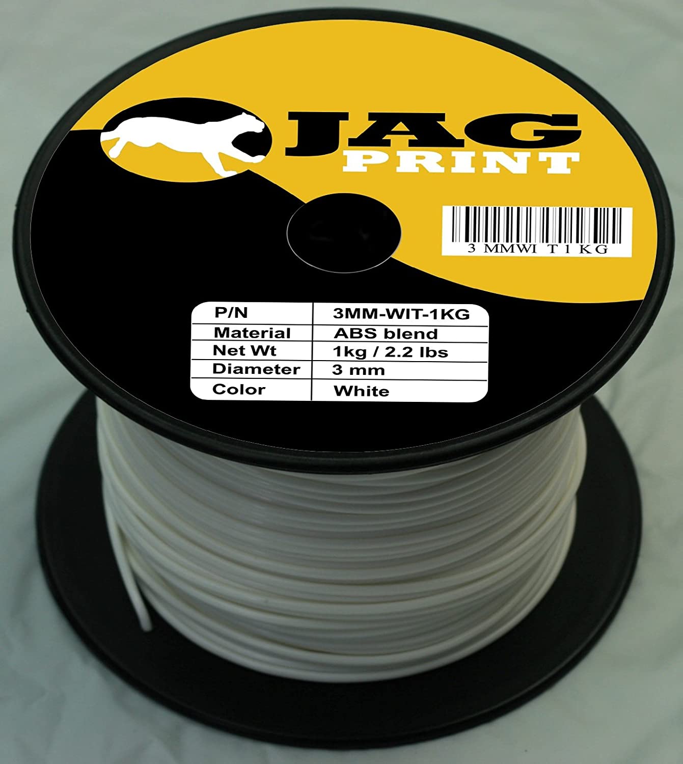

Word of warning - I’ve had some terrible experience on 2 occasions now with JAG 3mm ABS filament on Amazon - I was twice tempted by the price and prime shipping availability, but won’t mess with it again. Jams extruder frequently, traced it to air bubbles within the filament.

Yeah, I should have mentioned I never print with PLA, so am not a good source of information on quality of those filaments
