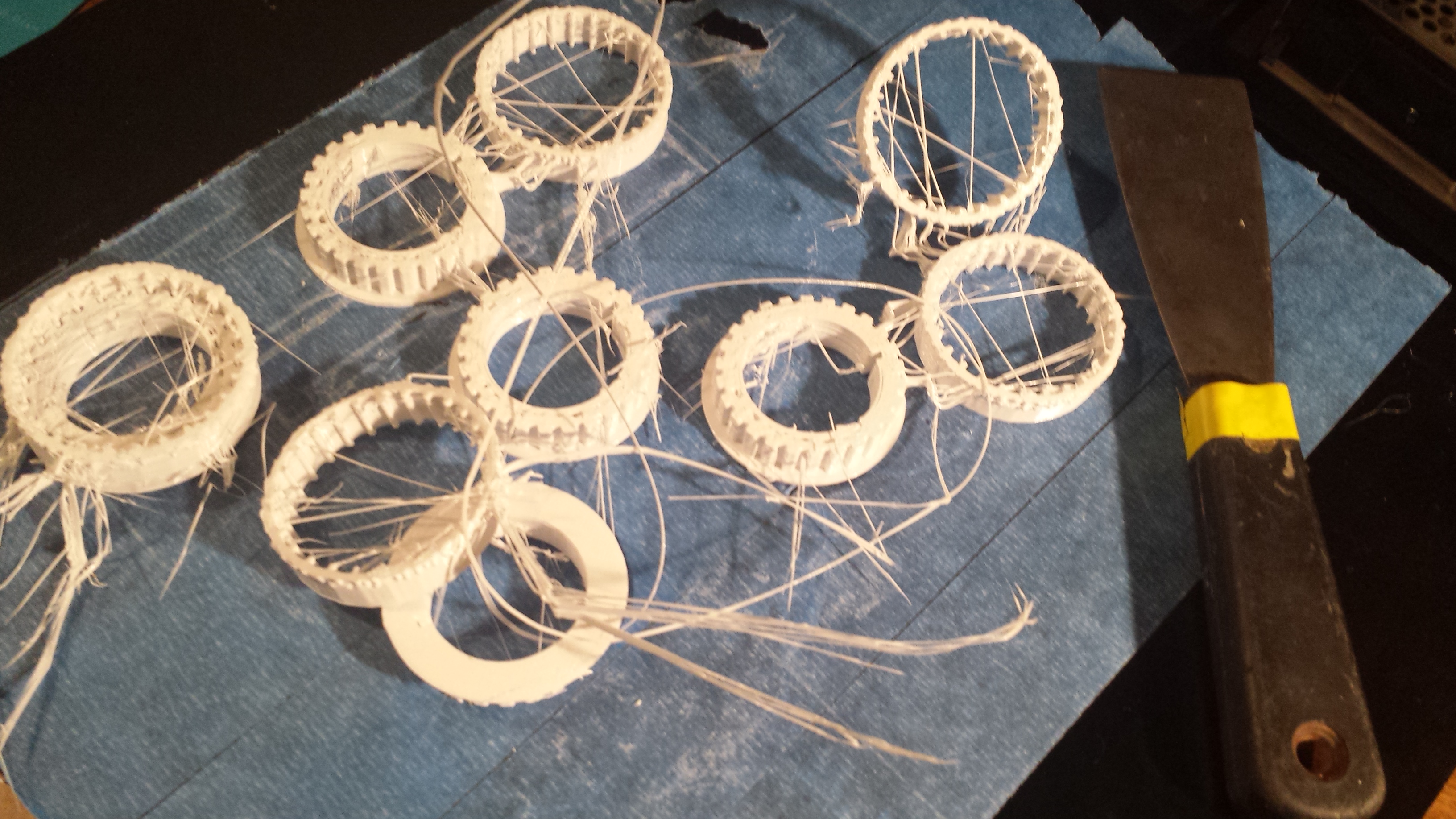

Word to the wise,
Word to the wise, don’t set the retraction on Bowden extruders to 2mm
Very Tahitian
I think you forogt to account for the length of the tube…
I used 4.5mm at like 160mm/s if I remember correctly. It’s been a while since I ran Bowden. I want one of each haha
