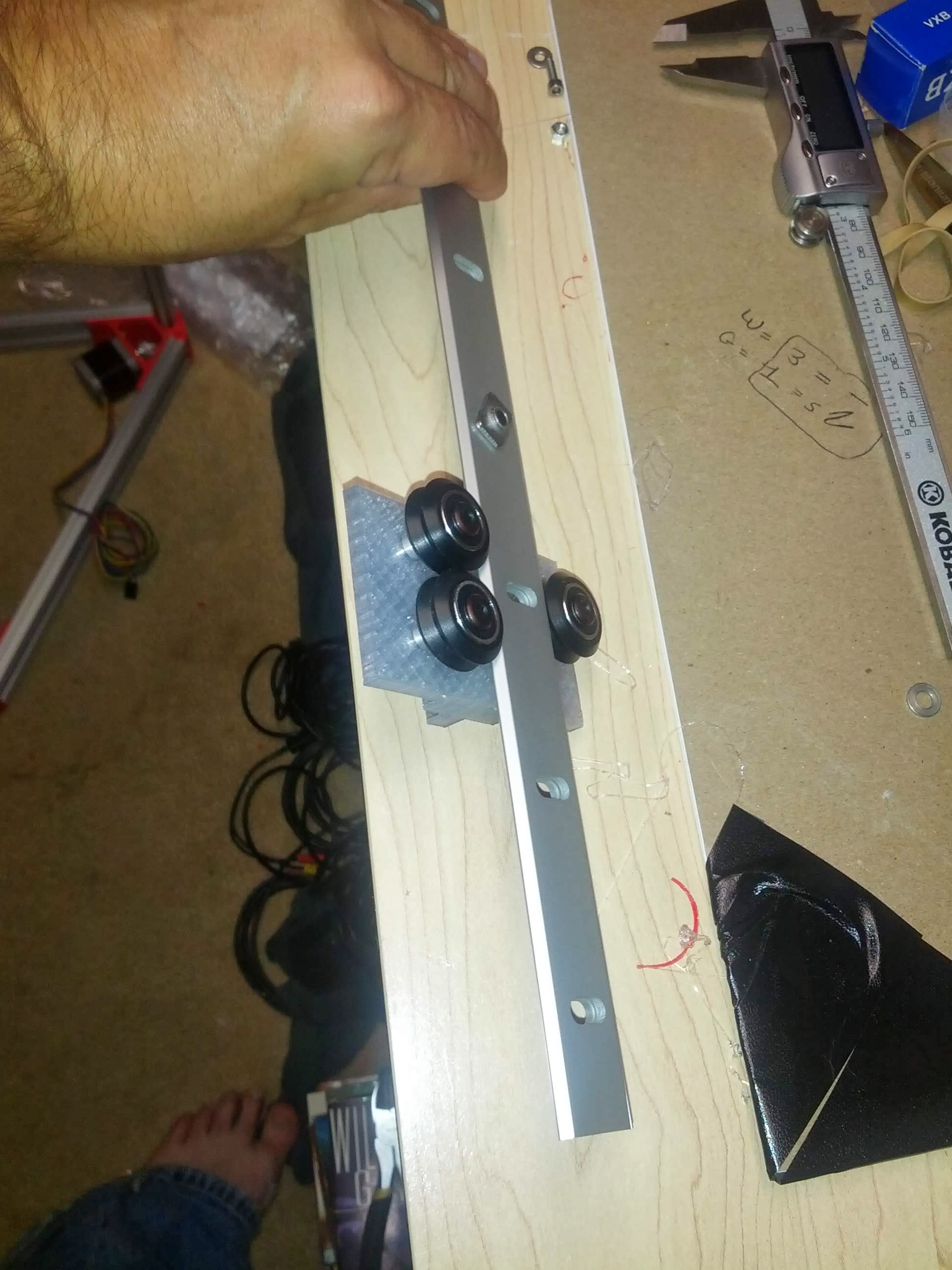

Work continues on my modified Kossel printer.
Work continues on my modified Kossel printer. I am trying to make my slide with @Mark_Carew_OpenBuild (open builds) parts. So far so good but I have some adjusting to do to the part because it now sits out to far from the main beam and the belt will not work. But it is moving forward slowly.

Hey @Mark_DeNeve , looking good. Where you source those v-wheels?
@Jason_Ray I got them from http://openbuildspartstore.com I believe this is @Mark_Carew_OpenBuild ‘s store. I am quite happy with parts so far but one word of warning that I did not know … In order to make the rail like I have in the picture you need two of the rails. It appears he has made this more clear now on the web site. I have to order a few more once I work everything out.
I know about the double rail need. I designed a version for openbeam as well to be printed, but I just can’t convince myself to pay… wait a minute… That price looks way different that the €6 per wheel I saw earlier in the year! You can check my design here: http://www.youtube.com/watch?v=oCHQfyNuU5M&list=UUvELI6pLxKp7-euRdXhNvIQ Thanks! and good luck on the build!
