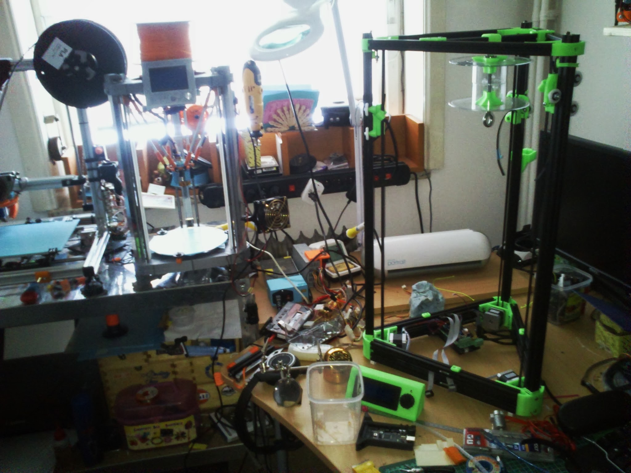

Work in progress :
“custom Kossel maxi” aka “Sardaukar”.
main goal: silence and big print area
2020 frame
+/- 250mm³ print area
magnetic ball joint
POM roller
vibration damper on motors(cork) and frame(flex foot)
Work in progress :
2020 frame
magnetic ball joint
POM roller
what is the size of the printable area? Also where did you get those wheels?
I hope the print area will be 260mm diameter and 250 height.
the wheels are 22mm Shower roller/slider (POM plastic and bearing)
realy sheap to buy , good quality and quiet.
hey thats a great idea on the shower rollers!!!
ill be watching this build!
the idea is not from me i found it here http://www.thingiverse.com/thing:566093
i’ve remix it to match my rollers.
