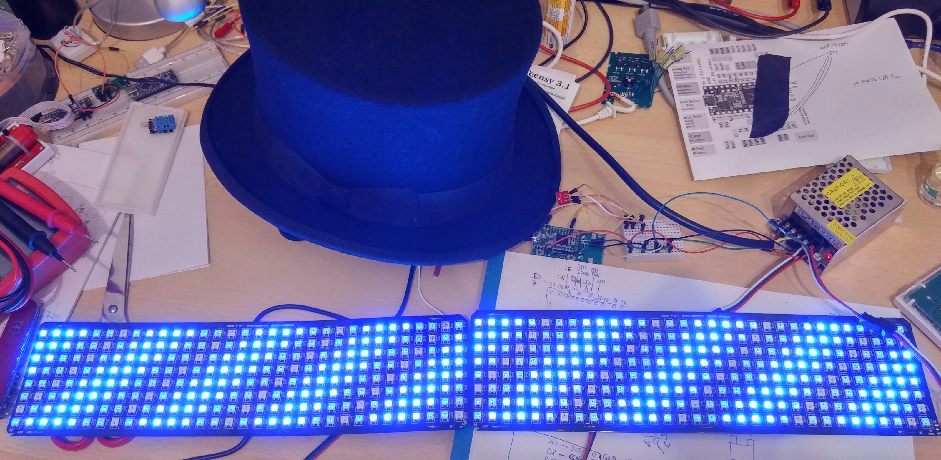

Work in progress. The flexible LED Matrices will go around the top hat soon.
I have yet to figure out how to power this beast properly (512 LEDs!)

I think that’s going to draw about half an amp even when it’s just displaying solid black.
(Check my math: you have 512 WS2812 pixels there. Each draws about 1ma when idling at 0x000000 black. 512 x 1mA = 512mA ~= 0.5A )
@Gottfried_Mayer ​ is going to need a taller hat to house all the needed batteries.
Nah, that’s where a couple of fanny packs come into play. :slight_smile:

Nice! Where did you get the LED matrices?

Hi, it looks nice… which power supply are you using in your test setup?

@Derek_Wilson I got the matrices off ebay: http://www.ebay.com/itm/8-32-256-LEDs-Full-color-WS2812B-WS2812-5050-RGB-Flexible-Pixel-Panel-Light-DC5-/251698964775?pt=LH_DefaultDomain_0&hash=item3a9a6d6927
I power(ed) my current hat (32*3 LEDs) with 5V USB batteries I usually put in my back pocket, but the cable broke about once every six months. For this project I am planning on putting two batteries inside the hat (powering the two panels separately) so I should not have the problem of cables breaking, but I will have much more weight on my head… I guess I have to try it when I am finished building it.
@Robert_Atkins , did you ever have problems with cables breaking in your LED suit?
@Rodrigo_Cortes I use a 10A 5V supply from china, the LEDs are running at setBrightness(32).
