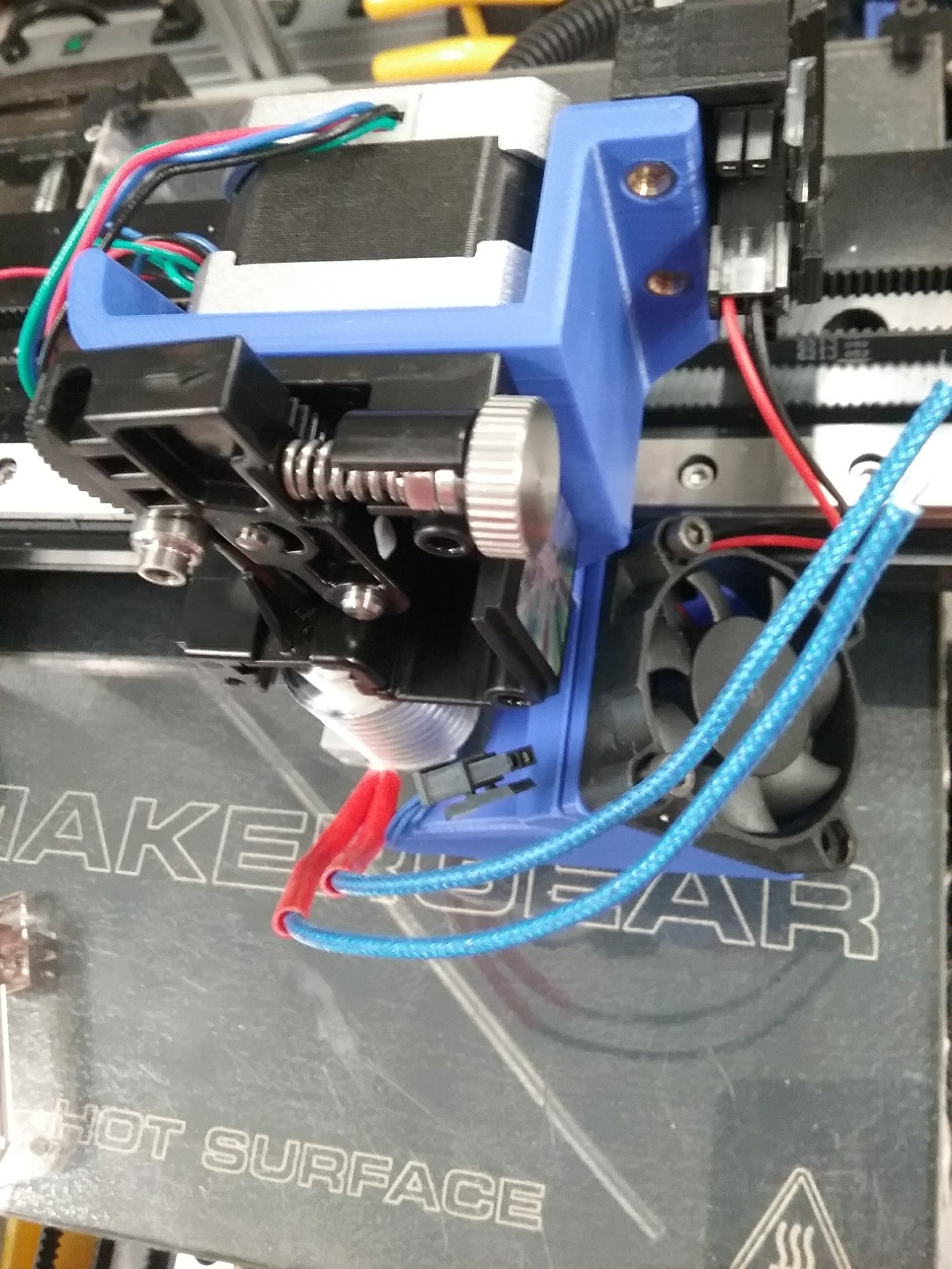

Work in progress (upgrading a makergear m2 to an E3D Titan with V6 hotend.)

If you’re getting both why not go for the Aero combo instead and save some build volume?
The aero might be too short. With this setup I designed the hotend to be in the exact same position as the stock hotend. Zero loss in volume.
Oh I guess the tip of the nozzle might not reach the bed with the Aero
