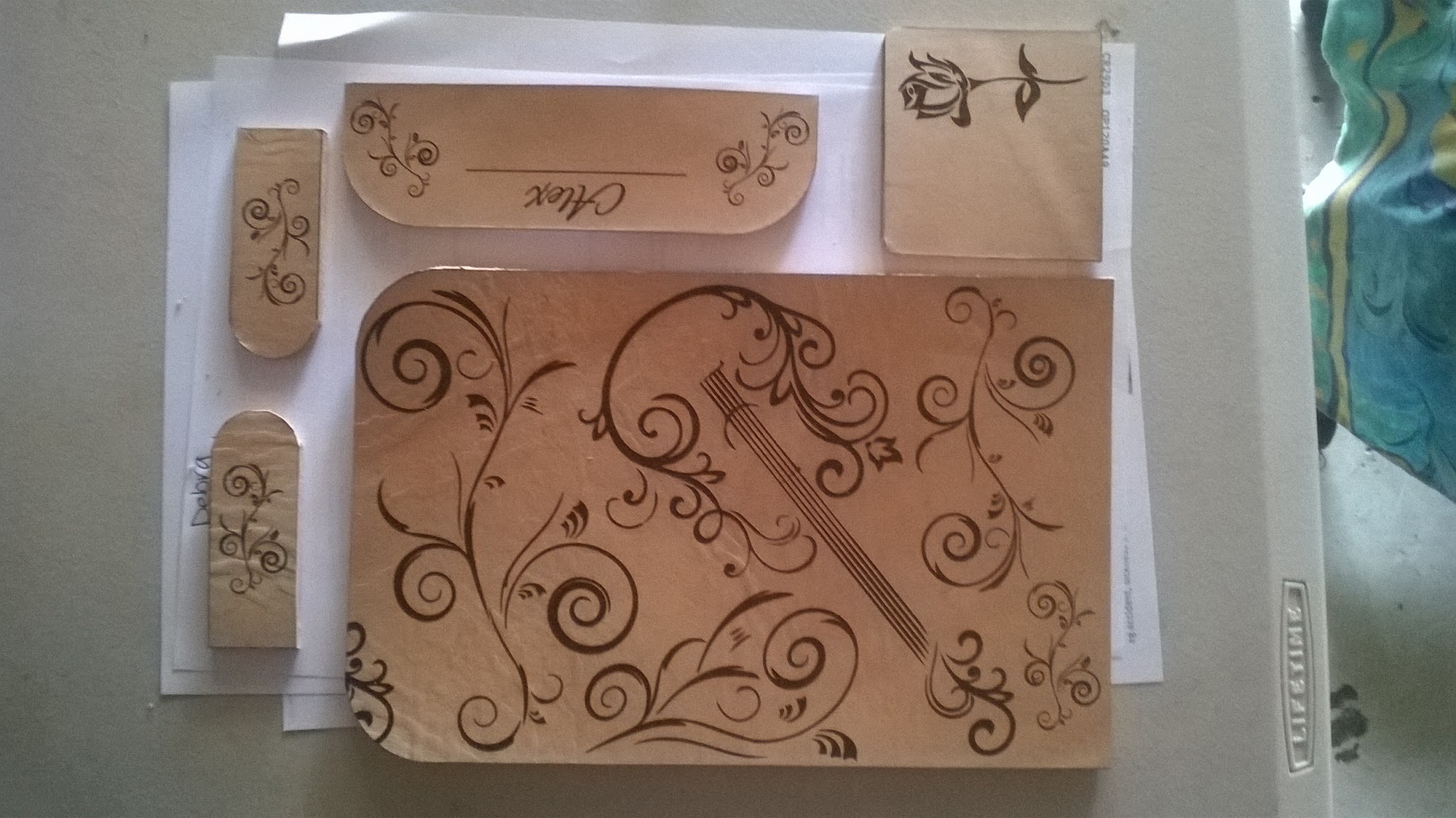

Working on a Leather Tobacco Pouch for a mate (as a test) with Laser Engraving.
The main piece (bottom & largest piece) took 3 hours to engrave with settings: 6mA power, 500mm/s speed, 1pixel steps, 1 pass.
I’m pretty happy with the effect of the laser engraving on leather. Definitely a great buy to add different styles to my work.
Is there anything I can do to speed up this process? Am I doing something wrong even?
