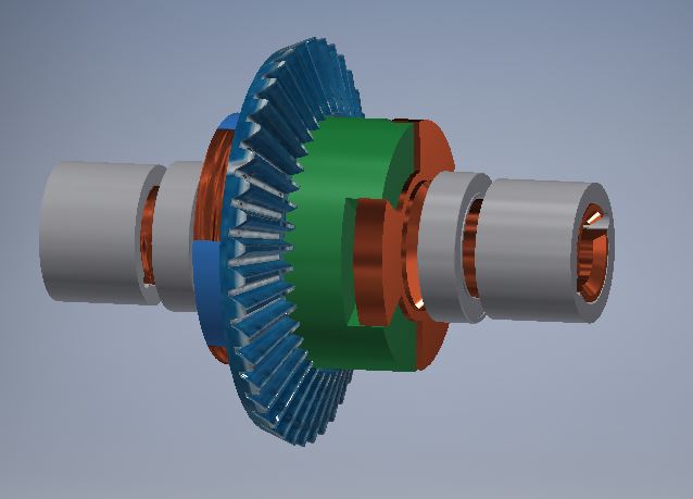

Working on a printed ball diff using steel bbs. I’ll post the cad models if it works. Fits in a slightly modified case.

You absolutely need steel washers for the bearing surfaces. bbs just sink into the PLA.
