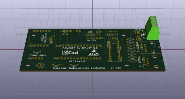

Working on a WS281X / SK6812 pixel controller that is aimed at driving just
Working on a WS281X / SK6812 pixel controller that is aimed at driving just over 8000 pixels. Comes in two parts the controller and the receiver. The receiver board can be powered with 5 or 12v power. Looking forward testing it out with the Octows2811 FastLED implementation!

Looking at the controller board, one thought I had-- Is there enough room to plug the USB jack into the Teensy?
@marmil yes the USB side is on the left between wiznet expansion port and and dmx serial headers.
