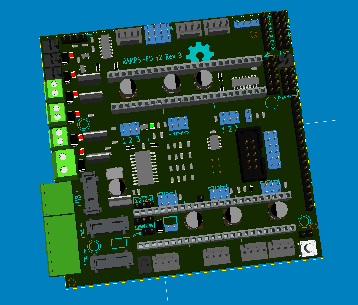

Working on RAMPS-FD v2…safer, better.
Cool! I want to se it!

I like it!! The ramps seems a little outdated but this is a nice little refresh.

I would ask designers of these boards to stop unneccerily shoving electrolytics right up against hot bits though. Other than that the board rendering looks beautiful.

I have a RAMPS-FDv2 board from OSHPark, and it needed modification and to work right (eg thermistor ref voltage circuit) and occasionally had weird hardware glitches that I could never pin down. For example, SD card reads from the GLCD would intermittently fail despite having shielded cables, and I had baffling issues with certain stepper driver sockets having inconsistent motion behaviors. (EG see https://github.com/repetier/Repetier-Firmware/issues/469) Couldn’t ever figure out whether the problems were in the RAMPS-FDv2, or some combination of the GLCD, GLCD adapter, or Due. All I know is that switching to RADDS and a different Due made all the problems go away.
What I’d recommend for any future board is to NOT try to be 5v and 3v3 compatible in the same shield. It makes everything more complicated and adds failure points that are difficult for end-users to troubleshoot (like level-shifter timing issues). Separate shields for separate voltage levels is a better approach.
Hmm, quite a bit of stuff to unpick here… V2 was also an unreleased beta, so if people are selling it on OSHPark they shouldn’t. It’s not just Geeetech who are playing that game then. No one told me they were selling v2 boards - nor that they had designed a v3.
The problem with uncontrolled use goes with Open Source, people need to be aware of that.
I don’t think I received any emails or issues, so if people had problems I wasn’t aware of them. I can only fix things I know about!
The analog reference problem I am aware of and have fixed.
Due is 3v3, LCDs are 5V, so there must be conversion, that is inevitable. RADDS decided to put an onboard level conversion for a dedicated LCD connector, I did not, which would explain that issue. If you use a 5V LCD with a 3v3 board, then expect problems. I have even less control of what addon boards people make or how they use them!
There is no level conversion involved in the stepper signals, they go straight from the Due to the steppers. If you had problems there, it is not due to the design of RAMPS-FD - probably a bad Due.
So from all the things mentioned, the only concrete issue is the analog reference which I’ve fixed, the other things are not related to RAMPS-FDv2.
I urge people if they do have issues, raise them on the github page for the project. It’s the only way they will get properly investigated and hopefully fixed.
