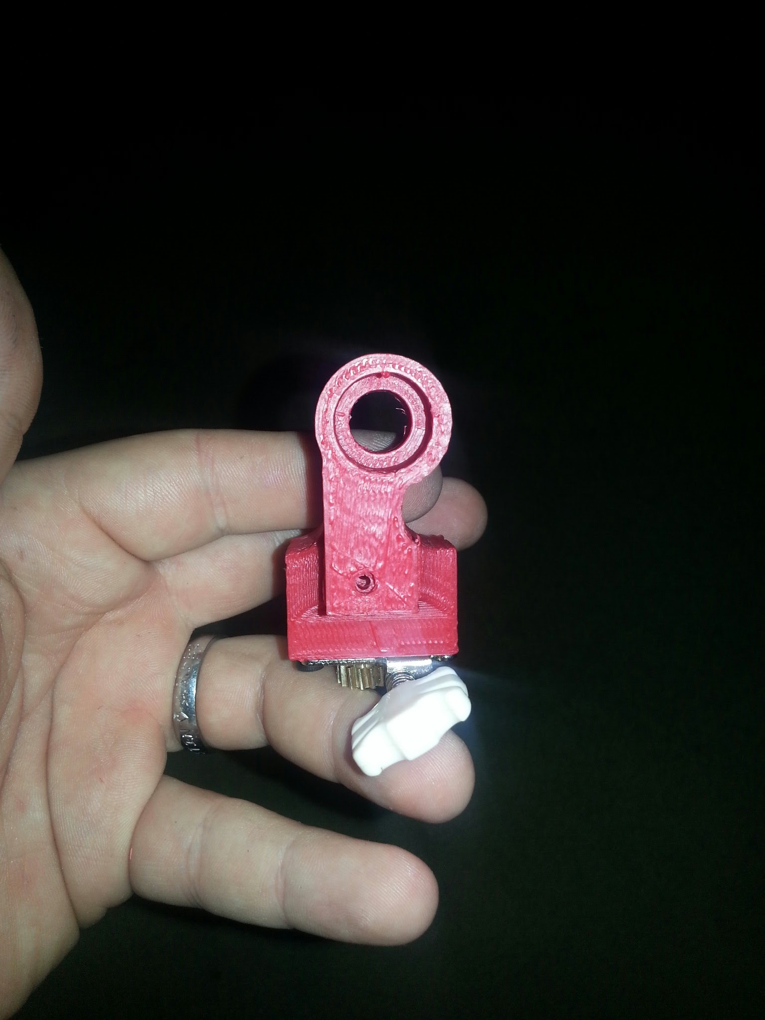

worm tightened xy ends

Hah, I bought a set of those exact same pegs for the exact same application just a day ago. Seems like you beat me to it, @D_Rob .
@Dale_Dunn adding a spring without a rigid motion limiter will always result in added elasticity in the linear drive. But again, having that hard limit in place kinda defeats the purpose of using a spring in the first place, so a rigid tensioner, like pegs, really is the best way to do it.
I made those about 4 months ago
@Thomas_Sanladerer I have mad a few iterations of these and I can send you a coy of the current revision if you want. also the rest of my work
