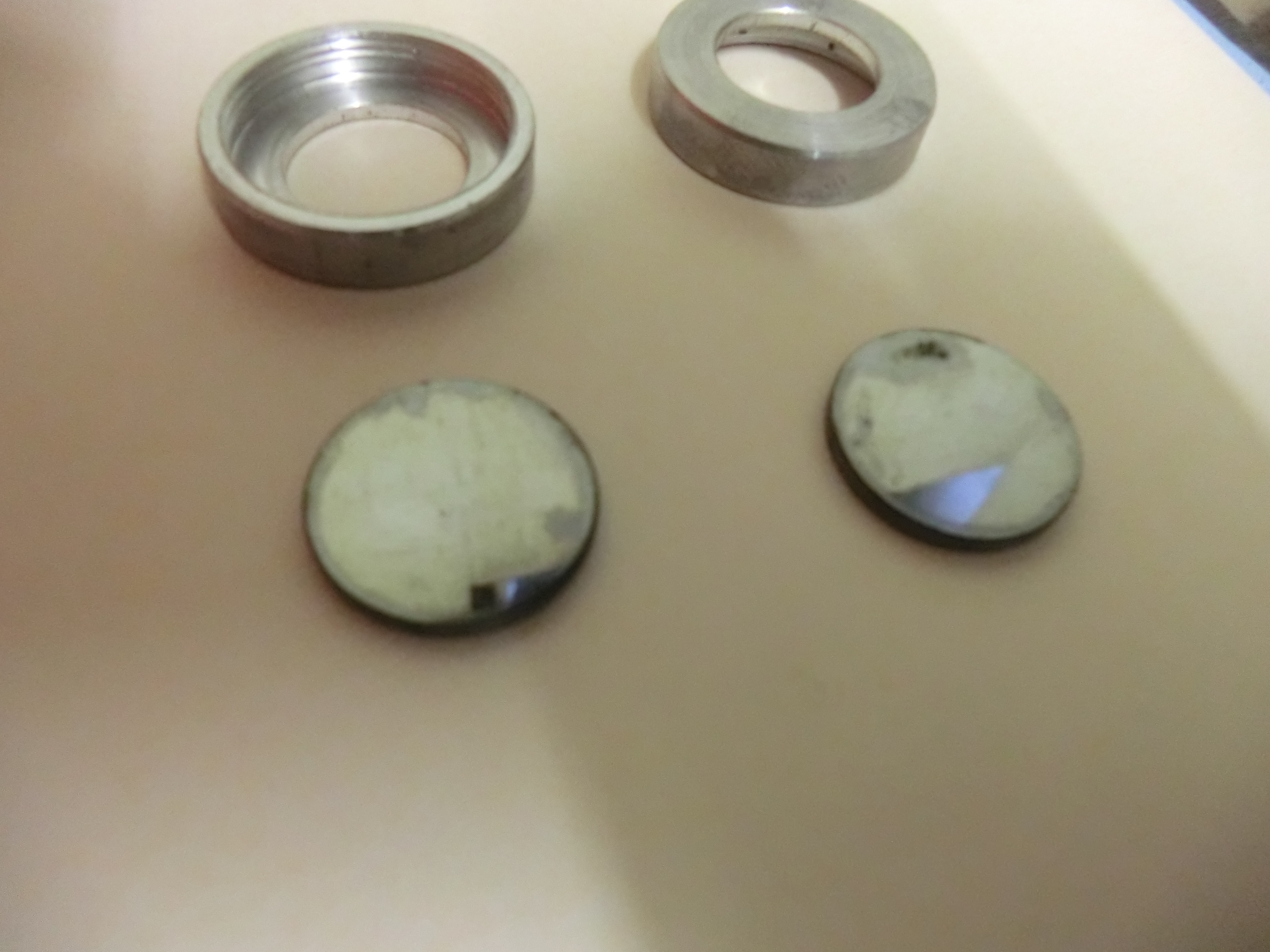

Yesterday i received my first K40.
The laser ran for approx. 5 minutes (real tube activity) and i cannot believe these 5 minutes caused the mirrors to look like this. (photo attatched)
And is it normal that the mounts for the bed are not in 90° to the housing?
Am i too picky?
Or did i receive a rather trashy specimem and should contact the seller?
Unfortunately that’s some what typical for stock mirrors. It’s not acceptable in my opinion. But it’s generally recommended to replace the stock mirrors anyway with some better quality mirrors.
The side you are showing look more like the backs. Is that the most reflective side?
I wish it was the back side. It is in deed the “reflective” side.

That looks like it took some beating. I would contact the seller.
Mine was the same. Standoffs sitting at an angle. Removed the stock bed and tightened up the standoffs. Replaced the bed with expanded steel. Working well so far.
Mirrors weren’t too bad on mine. Running stock ones for now until new mirror mounts and head comes in, then its upgrade time.
I have sent the pics to the seller and told him that we talk about how to deal with them when i have the machine fully inspected.
