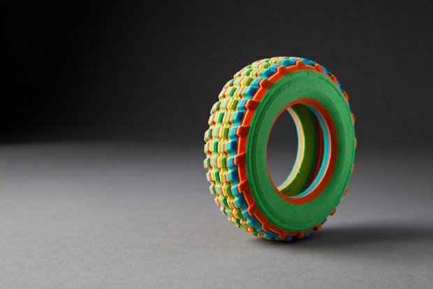

Would you describe this as "Full-Colour"?
Would you describe this as “Full-Colour”? I certainly wouldn’t and have written a blog about the fast-and-loose use of the term in the #3DPrinting world. Read More > Nailing my colours to the mast? What is full colour 3D Printing? - TCT Magazine
To me, a full-colour 3D print means that the outer surface has been rendered in CMYK dots like a 2D colour inkjet page.
I agree @Paul_Gross , I think while the industrial world strives towards this with Connex etc it is unethical for desktop machines to claim “full colour”
If our open-source machines can actually implement CMYK colour, then that would be unparallelled.
The closest industrial method for CMYK 3D printing is a machine that sets gypsum (plaster) 3D models, adding water-based pigments to the gypsum. It looks OK, but plaster is not a very useful material to me.
A thermoplastic with colour pigments applied to the outside surface would look awesome. Imagine Aria the dragon with her skin (scales?) rendered in photographic detail!
If that happened, then open-source printers would have moved ahead of the state-of-the-art for commercial 3d printing.

I’m from the printing/publishing industry and Full Color printing as was mentioned involves any process that can print an unlimited array of colors usually comprised of CMYK components. Anything less, regardless of how many available colors is called “Spot Color” printing.
Thanks Rob, Spot Colour noted for future reference!
Along the lines of Spot Color printing, I was thinking it should be called 2-color printing (dual head) or 8-color (?) printing in the case of the kickstarter project to feed multiple filaments into one nozzle.
To me, full color printing would be printing out a minion or tug boat fully colored…not one color or stripes of different colors. The only printer I think that is capable of that right now is a paper based 3D printer.
I’ve seen this described way too much, it’s sad really. For FDM I see only two viable methods for real color printing, a colored filament mixing system, and some sort of filament dyeing system. In both cases the mixing must be able to produce the desired color for any single point of an object. This layered rainbow crap, no matter how many colors, is no more “color 3d printing” than prints done from a single colored filament.
