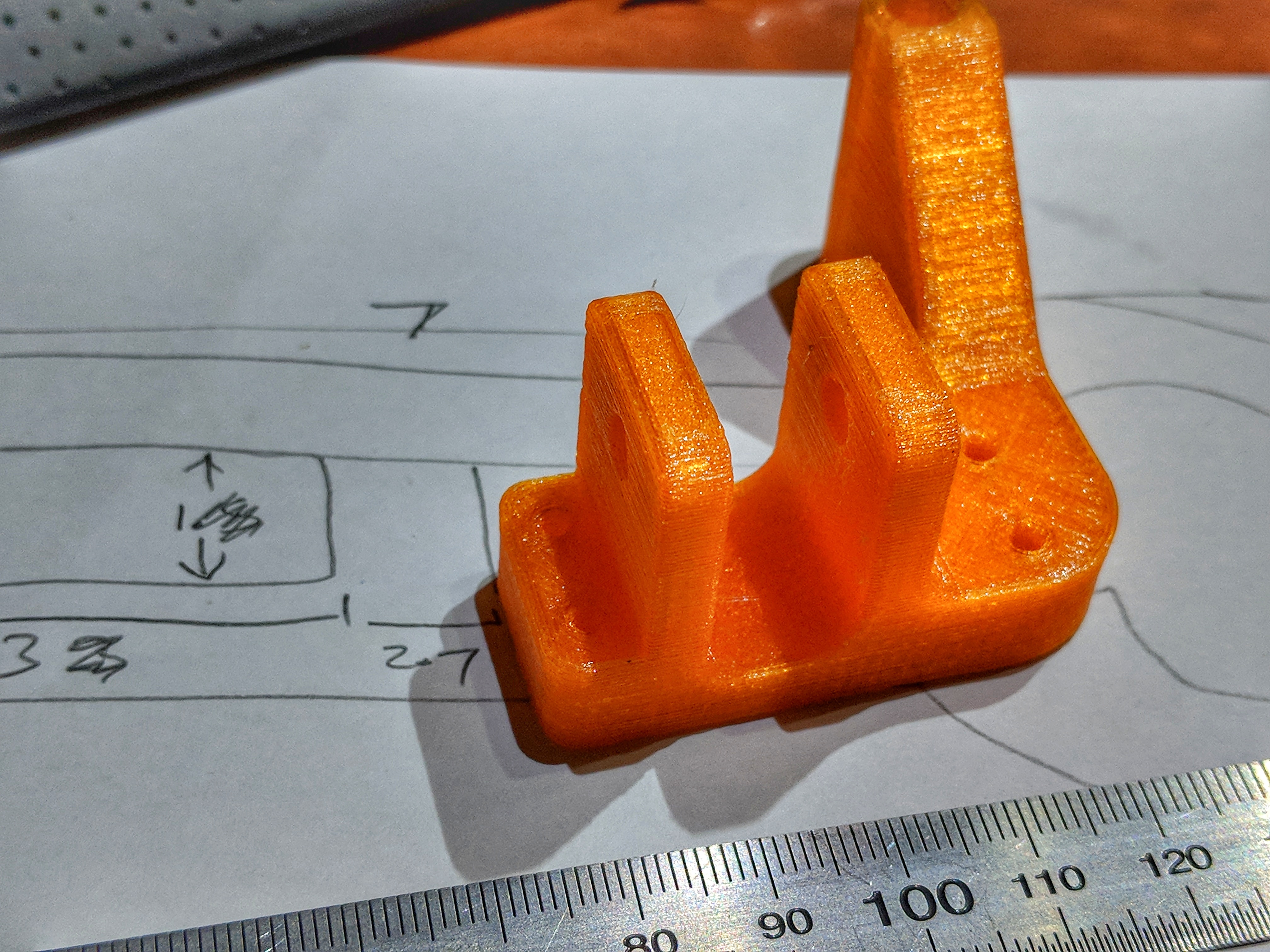

Wow… After printing a heat sensitive part in PETG, kind of shows you how shitty ABS is to print with eh?
This part from PETG has no warping what so ever. WooHoo!
As soon as you get past the stringing and get the prints dialed in petg is amazing.
ABS is amazing in a proper heated build chamber. Garbage in a cold environment.
