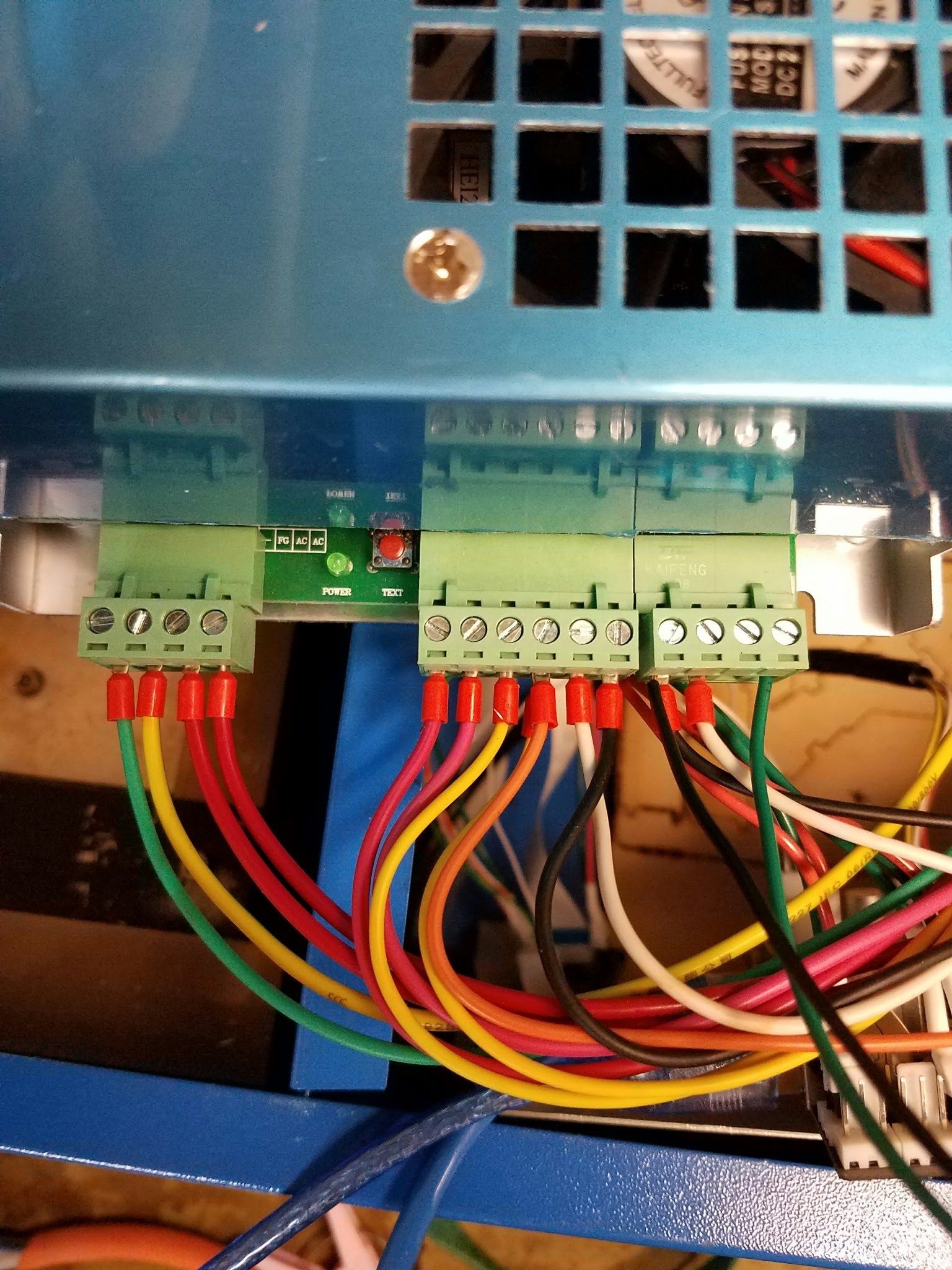

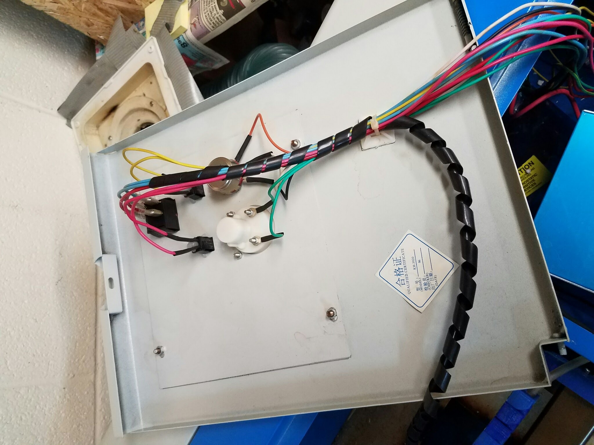

Thanks for the guidance, and thank you Don for for all your hard work on this project. Here is a picture of my setup. I will check the wiring back to the PS to make sure that I should be able to fire. Honestly, I’m almost ready to hang it up. The stock setup work so well for me for like 6 months, and it’s been a time and money pit since it broke down.
@Bradley_Blodgett can you also post the LPS end of the wiring. Btw I forgot the background. Is a stock machine that broke?

Below when I refer to “Test Sw” insure that the “Laser Sw” is on. Terminals are numbered right to left. Connectors are right/middle/left going right to left.
1.)You have added a smoothie and the laser stopped firing with the test button since that time, is that right?
2.) It worked before you added the smoothie, is that right?
3.) Does the test button on the LPS fire the laser with “Laser Sw” on?
4.) Is the green PWR light on the LPS illuminated?
5.) Where do the 2 black wires on the rightmost connector (terminal 4) connect to?
6.) Where does the white wire on the rightmost connector (terminal 3) connect to?
7.) Where does the black wire on the middle connector (terminal 1) connect to?
6.) Pull off the L wire (green) on the first terminal of the rightmost connector and try the “Test Sw”, does the laser fire?

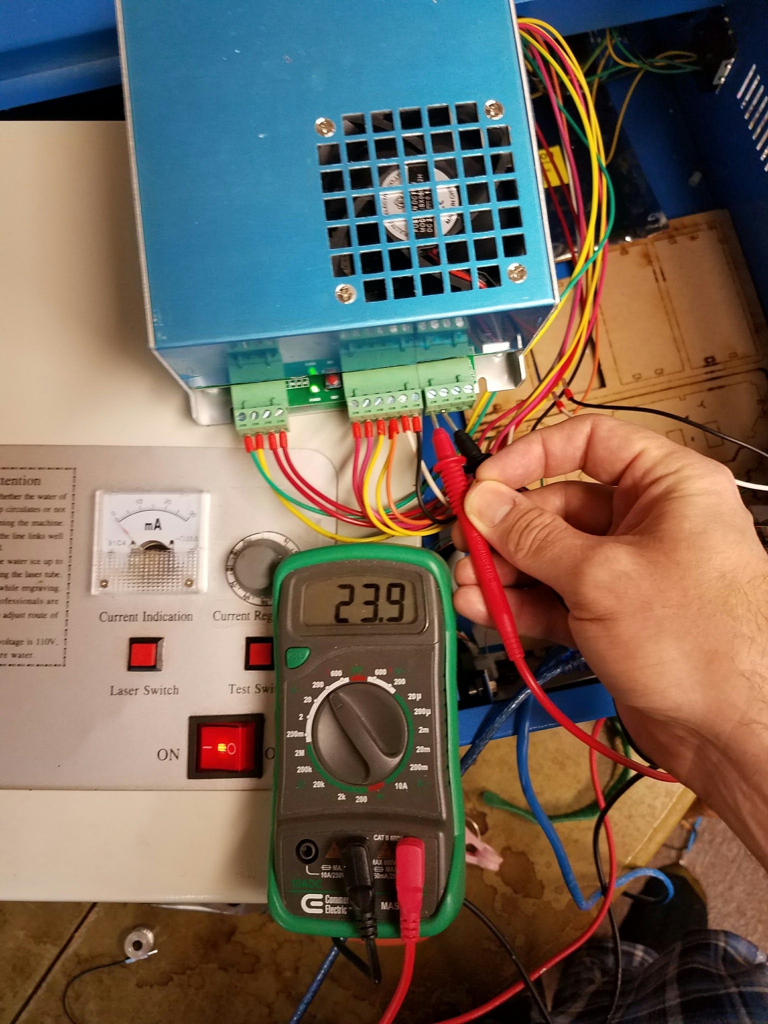

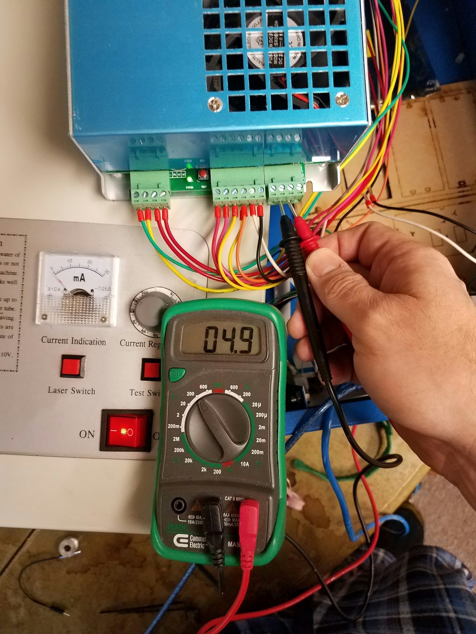

OK. lets pull ALL the wires off the rightmost LPS connector and check it.
Starting from the right set your DVM to DC volts and measure each pin identified below with the black lead on ground.
Turn on the power …
8.) check the second terminal for 5vdc when measured to grnd. Is it?
9.) check the 3rd terminal for 0vdc when measured to ground. Is it?
10.) check the 4th terminal for 24vdc when measured to ground. Is it?

10.) So the 24vdc was connected to ground right?

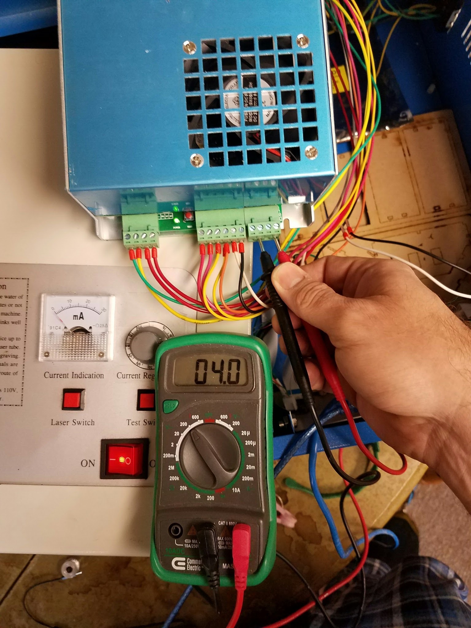

Now we need to measure the center connector. Don’t change any wiring and …
Starting from the right terminal on the center connector and measuring vdc to ground with your DVM…
15a.) terminal 1: does this measure 5vdc?
15b.) is this connected to one side of the pot?
16a.) terminal 2: does this measure some voltage between 0-5vdc?
16b.) does this wire connect to the center terminal of the pot?
16c.) does the voltage vary with the pots rotation?
17a.) terminal 3: is this terminal read 0vdc
17b.) does this connect to the other side of the pot?
18a.) terminal 4. this terminal should be empty where does the yellow wire go to?
19a.) terminal 5: with the “Laser Switch” engaged what does this read?
20a.) terminal 6: what does this read?

15a.) terminal 1: does this measure 5vdc? Yes
15b.) is this connected to one side of the pot?yes
16a.) terminal 2: does this measure some voltage between 0-5vdc? Yes
16b.) does this wire connect to the center terminal of the pot?Yes
16c.) does the voltage vary with the pots rotation? Yes all the way from 5 down to 0
17a.) terminal 3: is this terminal read 0vdc yes
17b.) does this connect to the other side of the pot? Yes
18a.) terminal 4. this terminal should be empty where does the yellow wire go to? It connects to the test fire button
19a.) terminal 5: with the “Laser Switch” engaged what does this read? .015 v
20a.) terminal 6: what does this read?0v
