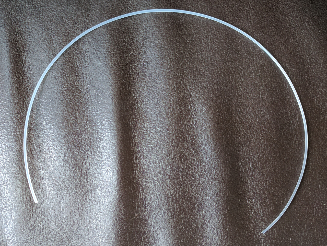

Wow – I thought Taulman were OK for quality control? Just had no end of problems which turned out to be my new roll of Bridge Nylon. All became clear when the filament was binding in the feed tube to the hot end.
Measuring the piece that was in the feed tube, it’s 2.04mm diameter at one point! And only 1.66mm diameter half a meter later (should be 1.75mm). You don’t need to measure, it’s clear to the naked eye it’s so far out – see the picture of the length that was in my feed tube – spot the thin and the thick end.

How many times did you measure it? I am just asking because a micrometer that I bought kept giving me some slightly different readings when I measured the same thing multiple times. If nothing else, it is a good thing for the others in the community to watch out for.
I measured that small length quite a few times (maybe five?). It’s pretty consistently around 2mm diameter for much of its length which is a little surprising for 1.75mm filament. My calliper seems to work well, seems to be consistent.

@Mark_Wheadon Please just contact us via the site and we’ll get a replacement out asap. Our Nylons are not extruded like other materials, but “drawn” underwater for almost 30 meters. While this process makes for a much stronger material, we have seen a few stretch’s get past the monitoring scanners. We do strive to make consistent line and always replace out-of-tol materials. We do know stopping a print in progress is frustrating!
