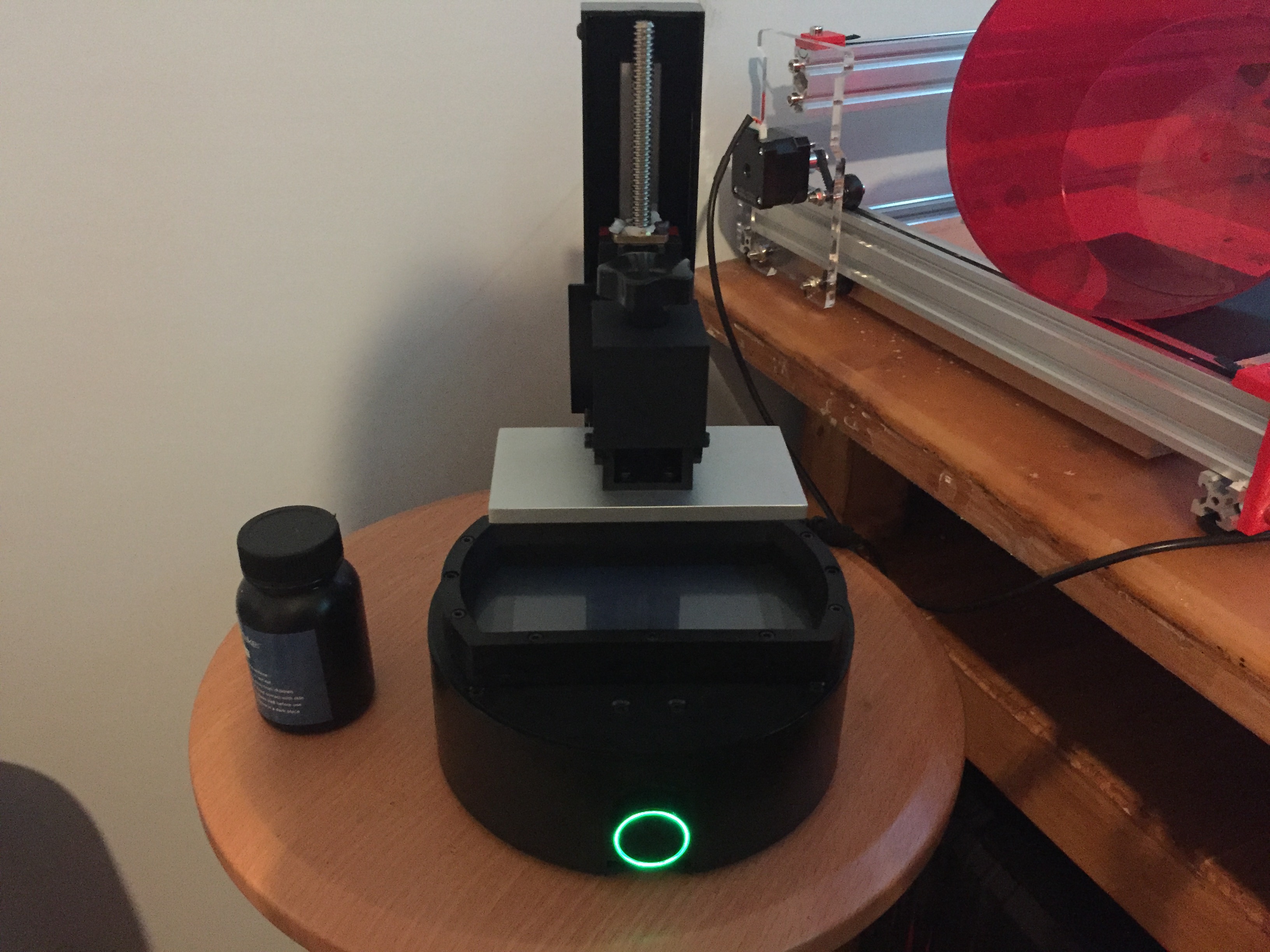

Printer setup is literally just plug in. My power pack worked fine but the kettle lead that came with it did not. I’ve just borrowed my solder station one for now.
The z axis is a 1/128 micro stepping stepper motor on what is seemingly a proper leadscrew and a linear rail with mount rather than bearing. This gives me confidence in the accuracy of the system in the dimension at least. The stepper and leadscrew are joined by the typical joiner. However look in front of the mechanical join there is a tab or switch. I wonder what that could be (nothing in the literature) but for now I am not touching it.

My guess is, that this tab/switch close to the shaft-coupler might be an optical end-stop-switch for the z-axis.
yep, 100% sure optical end-stop. See the that long vertical tab that is connected to the z-slider: its aligned with the switch at the bottom
I’m curious, what’s the machine next to it?
Eleksmaker laser engraver
