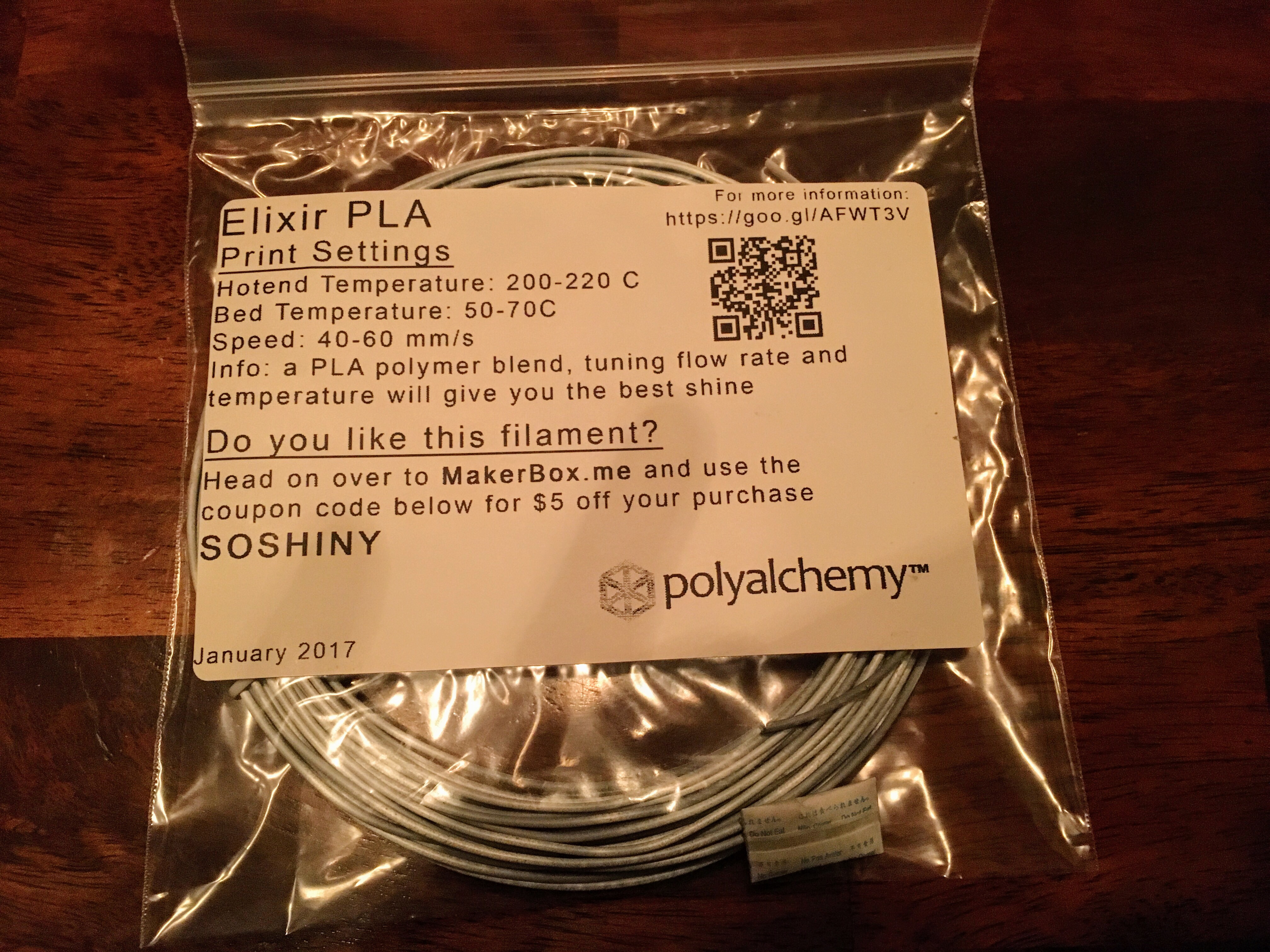

I feel like a little kid, when my MakerBox arrives every month…

Interesting looking filament! What slicer do you use? It would be quite straightforward to setup a test cylinder with bands at different speeds in simplify3d for example.

Ok, first test I bumped the temp 5 degrees every 10mm, I don’t see much of a difference except possibly the slightest increase in shine the hotter it went. I then realized that the cooling fan might be playing a part as you can see the lines in the process changes as the fan was off for the first layer of each.
