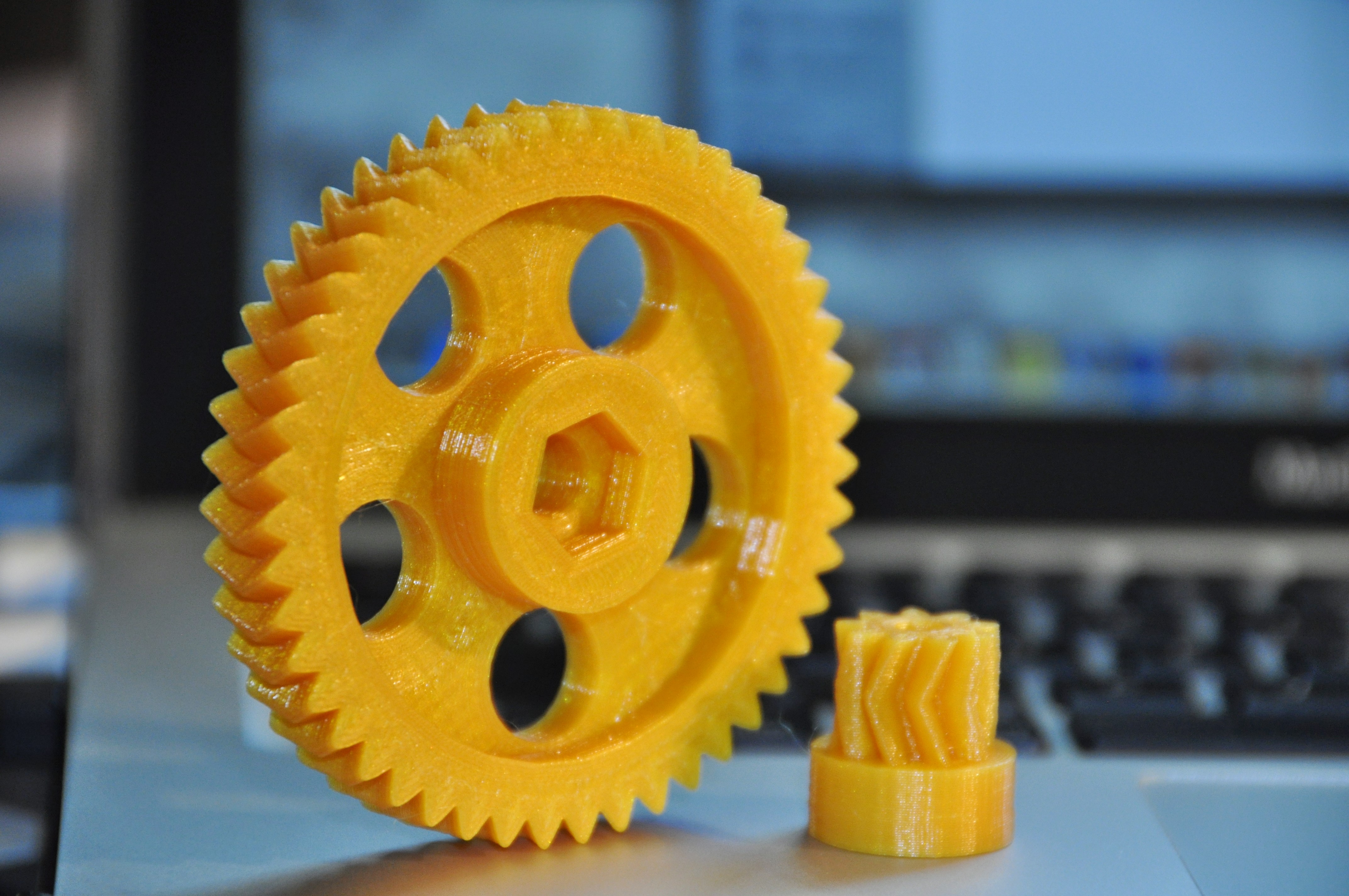

Nextime don’t do the herringbone gears for your extruder (I went through a couple of them but they destroy themselves since neither can move on their axels), rather look for spurgears…

@Marius_Kruger , thanks for the info and I just found an equivalent spur gear file to try.
