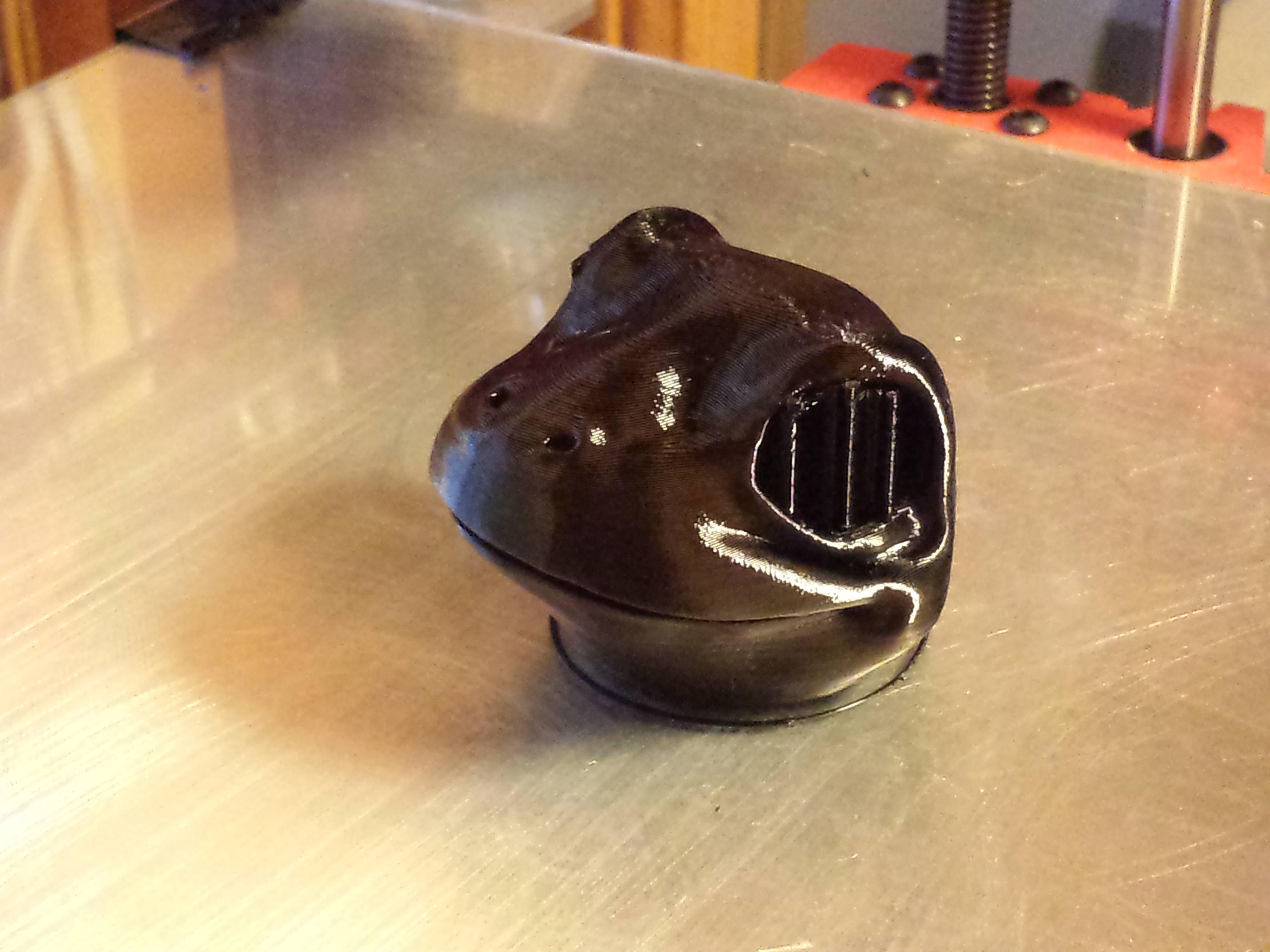

Wow, this black PETG from ESUN is great to print with. A few rolls showed up on Amazon and I snatched them up. Looks like its back in stock on June 20th.
Edit: I should have mentioned in the first place, this is the head for Froggy by the ever talented @Louise_Driggers
0.1920 layer height, 255C @ 45mm/s, 0.5mm extrusion width, 7.5mm retract at 60mm/s, 0.3mm coast to end, no active cooling, 10% infill, 2 perimeters, minimum layer time disabled, 75C bed, manual support placement in simplify3d, extrusion multiplier tuned with the single perimeter cube method, 1.003 scale factor for PETG shrink via 20x20 cube calibration.
