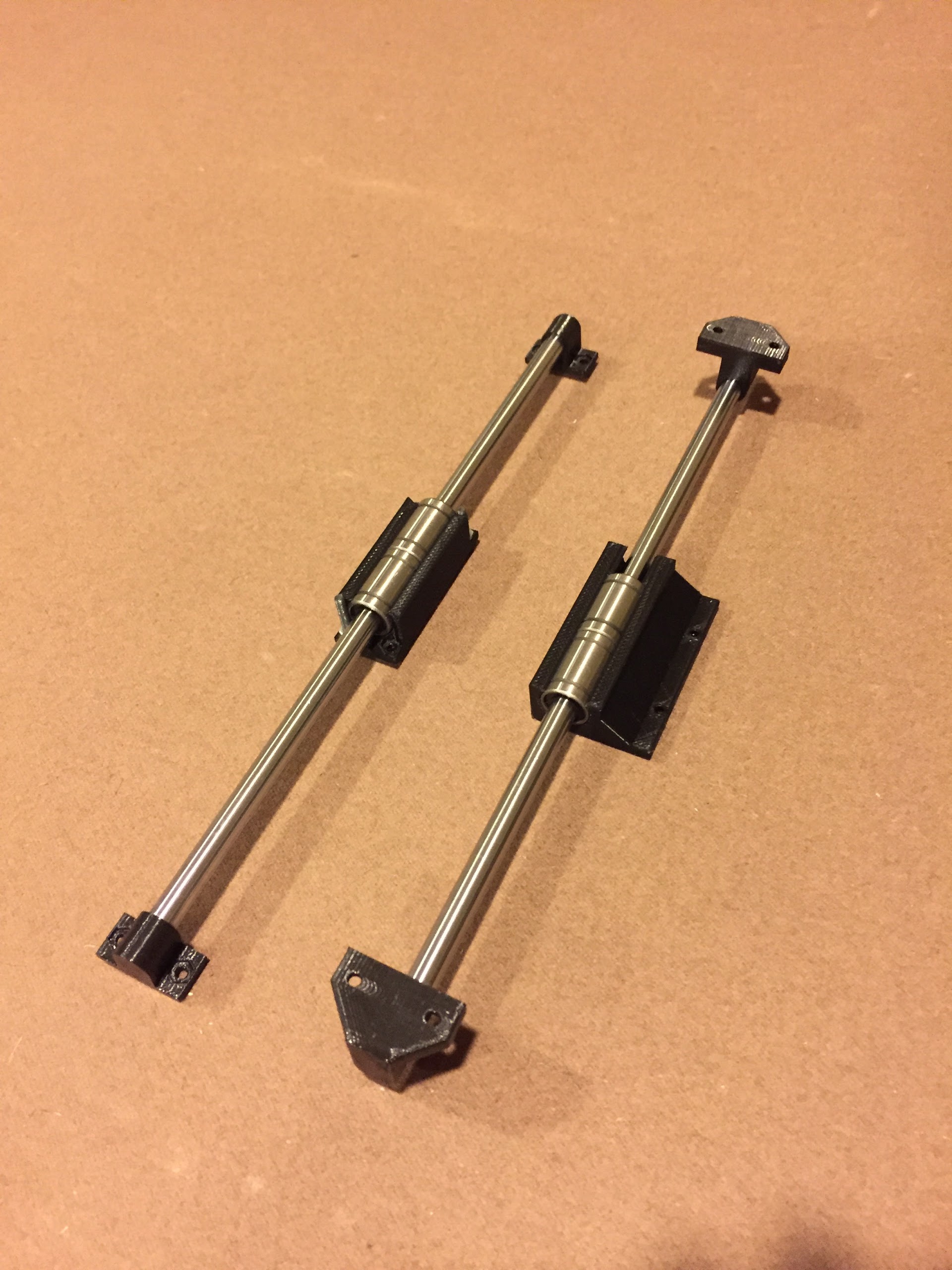

X and Y axis bearing inserts for the G-Rap Jr. (Printrbot Starter Kit 8mm).
X and Y axis bearing inserts for the G-Rap Jr. (Printrbot Starter Kit 8mm). After many many tests and revisions, the two pieces are finally fitting without the slightest movements. The X axis bearings are held in by the screws that also mount them to the extruder assembly and the Y are held in by the two walks. Because the printrboard is 61mm wide, I had to add a little bit where the bearings can’t slide into. Seems to be working fine but the true test will come when I try to print it.

And yes the 8mm version has completely different wood files. I did some serious reworking to add rigidity and make it more refined. With that the laser cut panels are now smaller and therefore more stiff.
I’m buttoning up the final touches this week and then @Brook_Drumm and I will be putting it through some testing. I would say the files for the 8mm version will be out within the next couple weeks.
