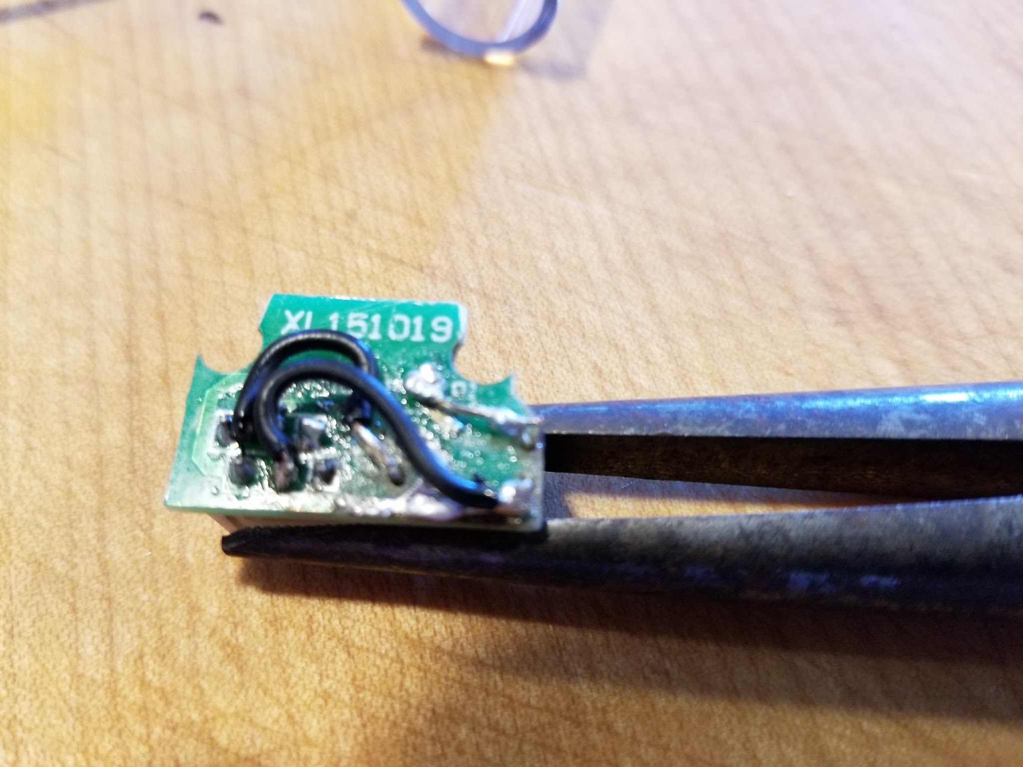

I had the same problem. My post is out here somewhere. The copper had been torn up from the board. Added wires to replace them, then realized the metal that sets off the sensor was too high. Made a new one from scrap.

But now I’ve got them it seems the pcb solder points are - well I guess gone…is there a way to make the holes usable again ? Or do I need to drill them out ? Or should I just tack wired from point to point? If so anyone got a wiring diagram?
Can you post a picture.
