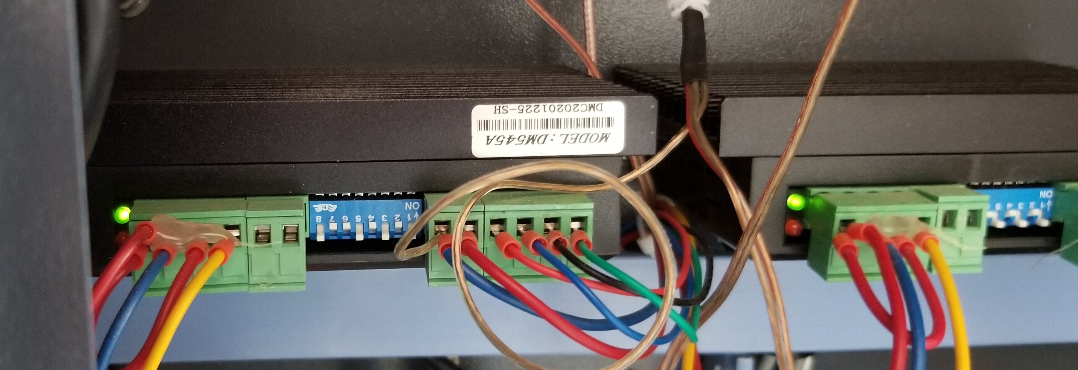

Check in the electronics cabinet to ensure your X motor driver doesn’t have an error indicator illuminated on the hardware. Each driver has a red led below the green… The red led option is a poor choice. :crazy_face:

Most of these are motor drivers are wired identically, so you could double check the wiring to ensure they are the same, and probably just swap the other motor driver to the Y axes to test the motor driver… If you are confident in your abilities and understand this, it is the most simple.
If you look at my photo, the single left connector is all you need to move to the other motor driver board. It’s one connector. The Y motor will respond but if you can move it from the machine console both directions it will indicate a bad driver.

Fixed it, it was a loose connector on the motor driver (red wire) connector block, it just popped out when I went to swap the x and y controllers as per Jack’s suggestion!
