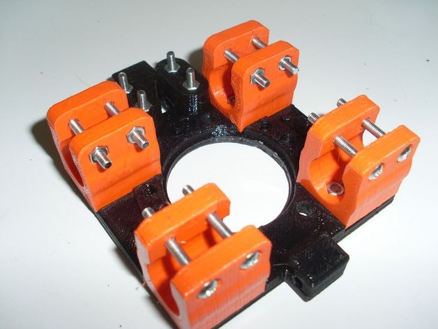

X carriage I got off thingiverse.
X carriage I got off thingiverse. Printed in tye dye nylon for the platform, and t glaze for the bearing holders. More pics to come as it completes
Print settings
Prusa i2
Garolite bed @30c
+E3d hotend 3mm
Nylon 265c
T-glaze 270c
Have to look at slicer for speeds
.4 tip .2 layer
tye dye nylon??
T-glaze??
I took 618 taulman nylon and rit fabric dye to tye dye the spool. The t glaze is a polycarbonate made by taulman also. I will post a link to them later
http://taulman3d.com/index.html
my colors we not as vivid(tye dye Nylon), i think because i didnt pre soak the filament in boiling water, and the dye was getting cool.
