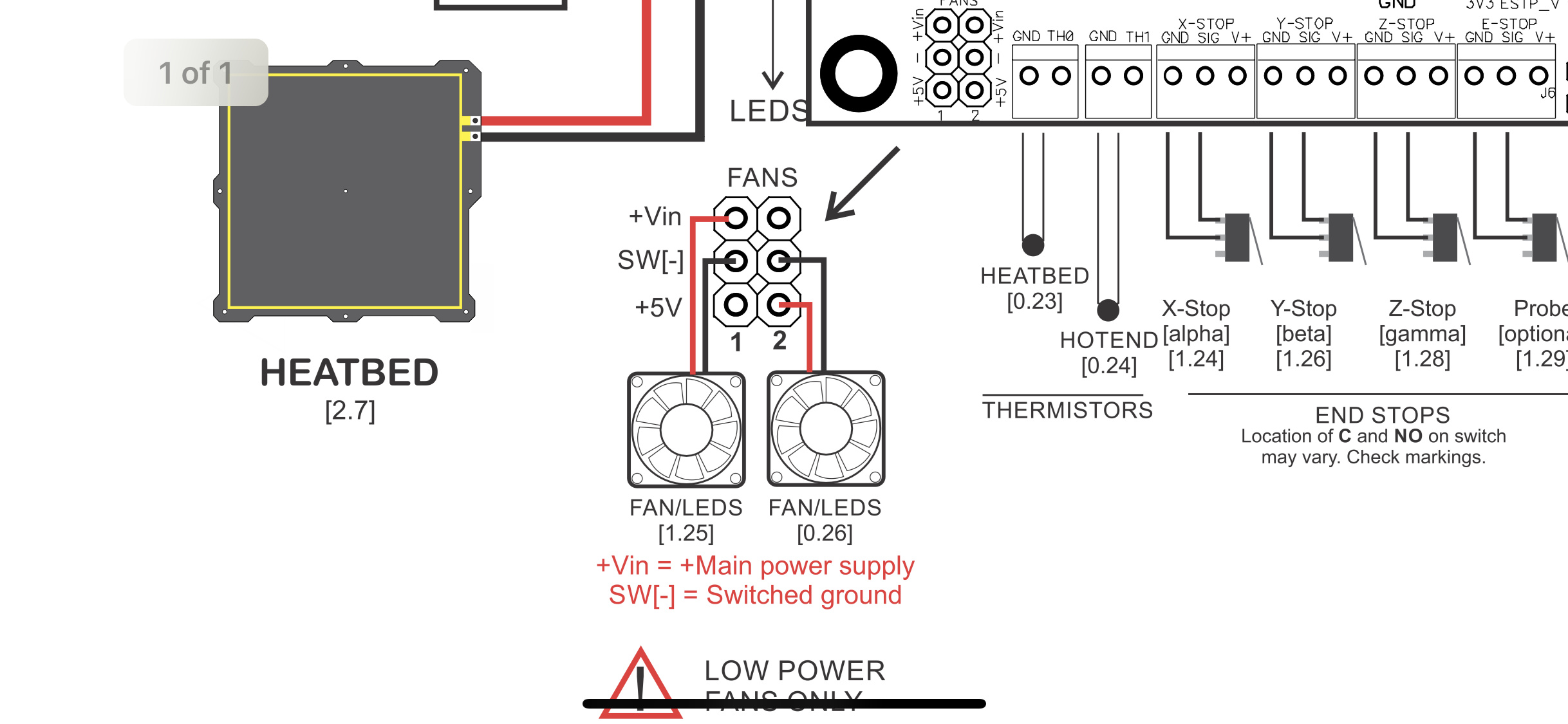

I’m looking at the wiring diagram and if I’m reading it correct, if I use a 24 volt power supply I should be able to use a 24 volt fan. Vin+ = power supply mains. So can the X5 Mini use a 24v fan and a 5v fan?
You are correct, just make sure your connector is plugged into the right pins.
