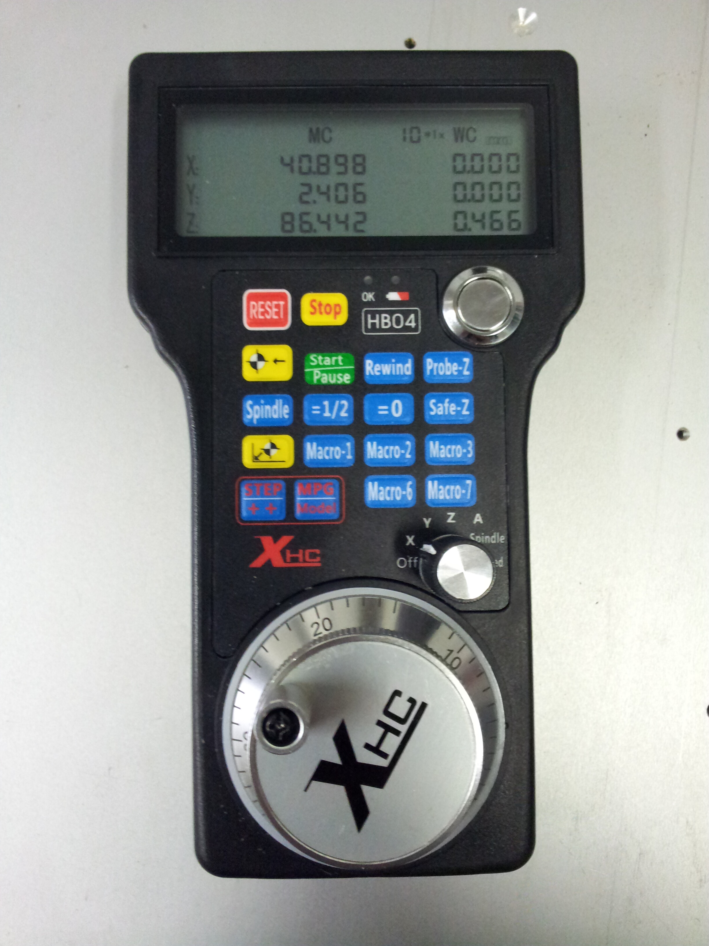

As you know I’m looking to integrate the XHC HB04B manual pulse generator pendant with LW4. So far I was able to get the keys working

I’ve been working quite a bit on the integration of the HB04B. So far so good! As of today I got the display working and the step jogging seems to work.

I just submitted a PR to support the HB04B. To enable, you can use either environment variable MPG_TYPE set to HB04B or modify config.js line
config.mpgType = process.env.MPG_TYPE || 'HB04B';
I didn’t go in details of the jog cancel as I’m using Smoothieware and can’t test easily with my current setup. I can use the STOP button on the pendant to halt the jogging if there are too many steps accumulated and I see it’s going to crash into something.
Overall I’m happy with the behavior. I can reset and pause, but can’t resume yet. The Stop will halt and alarm the control board.
Only drawbacks are hardcoded stepping values for continuous and step jog.
The feed rates and spindle rates aren’t showing as I couldn’t figure out how to make those work.
RESET will show when the board in in alarm, but it’s not 100% accurate, there are some instances where I wasn’t sure where to capture that state, yet it shows Alarm on the frontend.
For now there is no handling of machine coordinates, only workpiece coordinates.
Only for XYZ axis for now, couldn’t test with A axis.
FN+M-Home will cause a machine homing sequence, Z first then Y and X. Eventually I think we should revisit this as this is tied with the frontend as well. I feel it needs some coordination, single point of configuration.
FN+W-Home will zero at the workpiece
Axis selection must be set to something else than OFF for the display to work, this is a known bug with the pendant. It’s not a huge issue as the way it is programmed in lw.comm-server you need to hold down CONT or STEP in order for the jog wheel to be active, so even if you have an axis selected and you bump the jog wheel by mistake, nothing will happen.
For the step size selection, the 0.001 scale is the same as 0.01 scale. The LEAD position doesn’t do anything.
