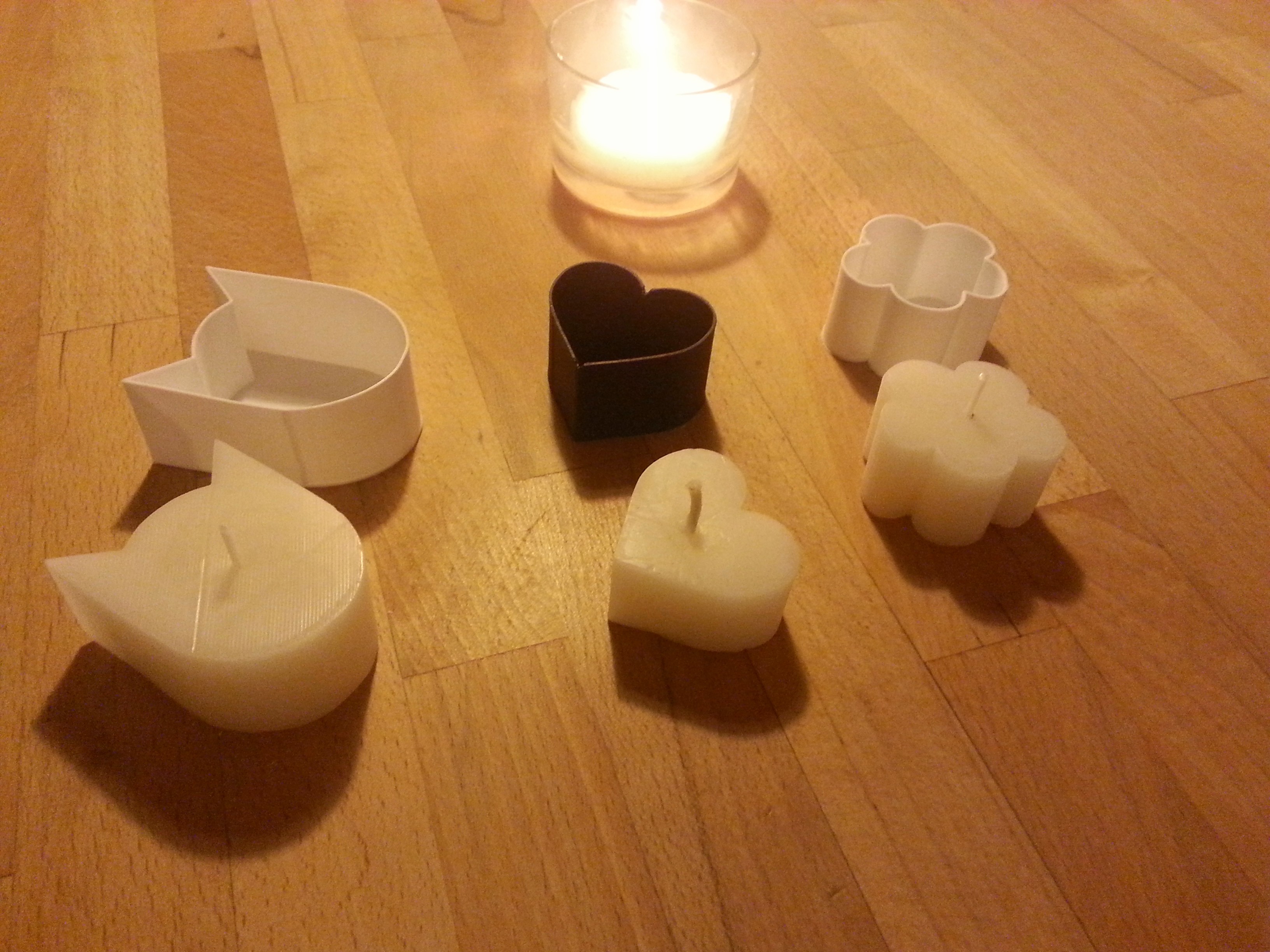

Xmas is gone, candles are still nice... The CandleCaster[1] works pretty well.
Xmas is gone, candles are still nice…
The CandleCaster[1] works pretty well. A bit tricky is getting the candles out of the cast. By now the cast is “cylindrical” (see green part). If I could extrude with @OpenJSCAD.org ​ any shape, then I would generate a tapered cast.
As long as this is not possible with “built in” functions, I recommend to use flexible PLA.
More about this in German[2]
