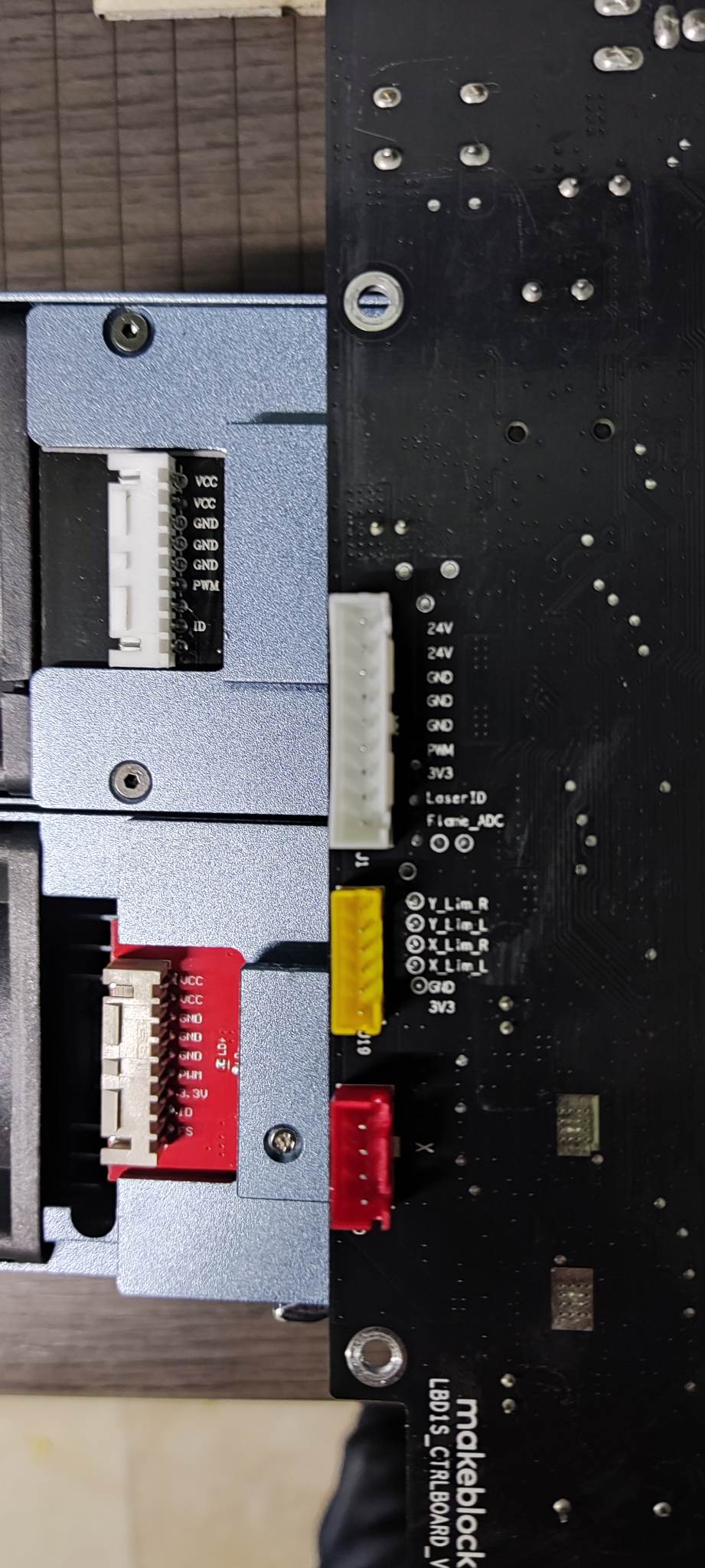

I recently bought an XTool D1 Pro 20W Laser Cutter/Engraver with additional IR head for all metal engraving.
And after just one day of normal use, it stopped working out of the blue, it just wouldn’t turn on the next day, I plug It in turn on the switch, and nothing no signs of life except one small blue LED next to the SIM card slot, which I do not know what signifies.
I tried a different power brick, the one I got with IR head, I tried different power outlets, and ultimately tested the output of the power bricks and both show 24V as they should.
Now of course I contacted the manufacturer ASAP and told them the same thing, it is the weekend, so I might wait for their response a while, and I hope they will send me a replacement board since I just bought the machine and paid a not such a small price for it with all the add-ons.
But this got me thinking, could there be another board that I could use in place of the original one, something like a Smoothieboard, Cohesion3D, or some other GRLB type of board like something from OpenBuilds?
The gantry cinematics is no problem, what is bothering me is the Laser Head wiring.
You see their heads use some 9-pin connectors 2x 24V, 3xGND, 1xPWM, 1x3v3, 1xLaserID, and 1xFlame_ADC which I assume is their smoke detector, the 3v3, and Flame being absent from IR Head.
I have not seen this many pins on any other laser head and would not know how to wire it.
My Idea is that I could build a larger gantry and position the other head on it because the Xtool has a working area of only circa 400x400mm
Here you can see the pictures of the current board and the Laser Head pinouts.
Top Laser Head is the IR one.
You see this board died and is only displaying this blue light.
Anyone with more experience dares to help me solve this conundrum?
Perhaps when I get a new board I could send this one to some electrical magician/technician, and he could fix it, I assume it’s just some blown fuse since it doesn’t show any signs of charing or heat damage anywhere on the board.

Turns out it bricked during automatic update. So manually flashing the firmware did the trick.
Just to be clear, @dougl comments were referring to the ugly linked troubleshooting guide, not you.
My apologies, my comment was a poor effort at a joke about the troubleshooting guide section I had linked to.
Happy to hear the real problem was a failed firmware update(hidden from the user?) and success was made doing a manual firmware update.
How did you manually update the firmware? Mine is currently flashing the blue light on the PCB board.
Through Xtool Creative Space, their official software, there is an option to manually update, just make sure to switch the button on the board that allows you to make an update.
