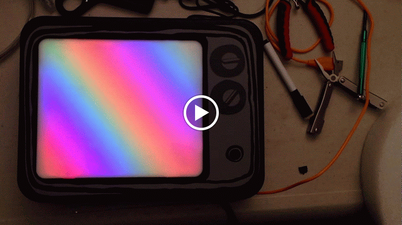

XY Matrix
16x16 matrix (256 pixels) driven by an Arduino Nano, plastic diffuser, and faux TV.
Here’s the complete code for this effect; the whole program is well under a hundred lines, and the ‘effect’ itself is just twenty lines. Compiled code size is 3,756 bytes.
(This same code also pasted here XY Matrix sample (draft) - Pastebin.com )
A more fully commented version of this XY example code will be included in the v2.1 release of the FastLED library.
