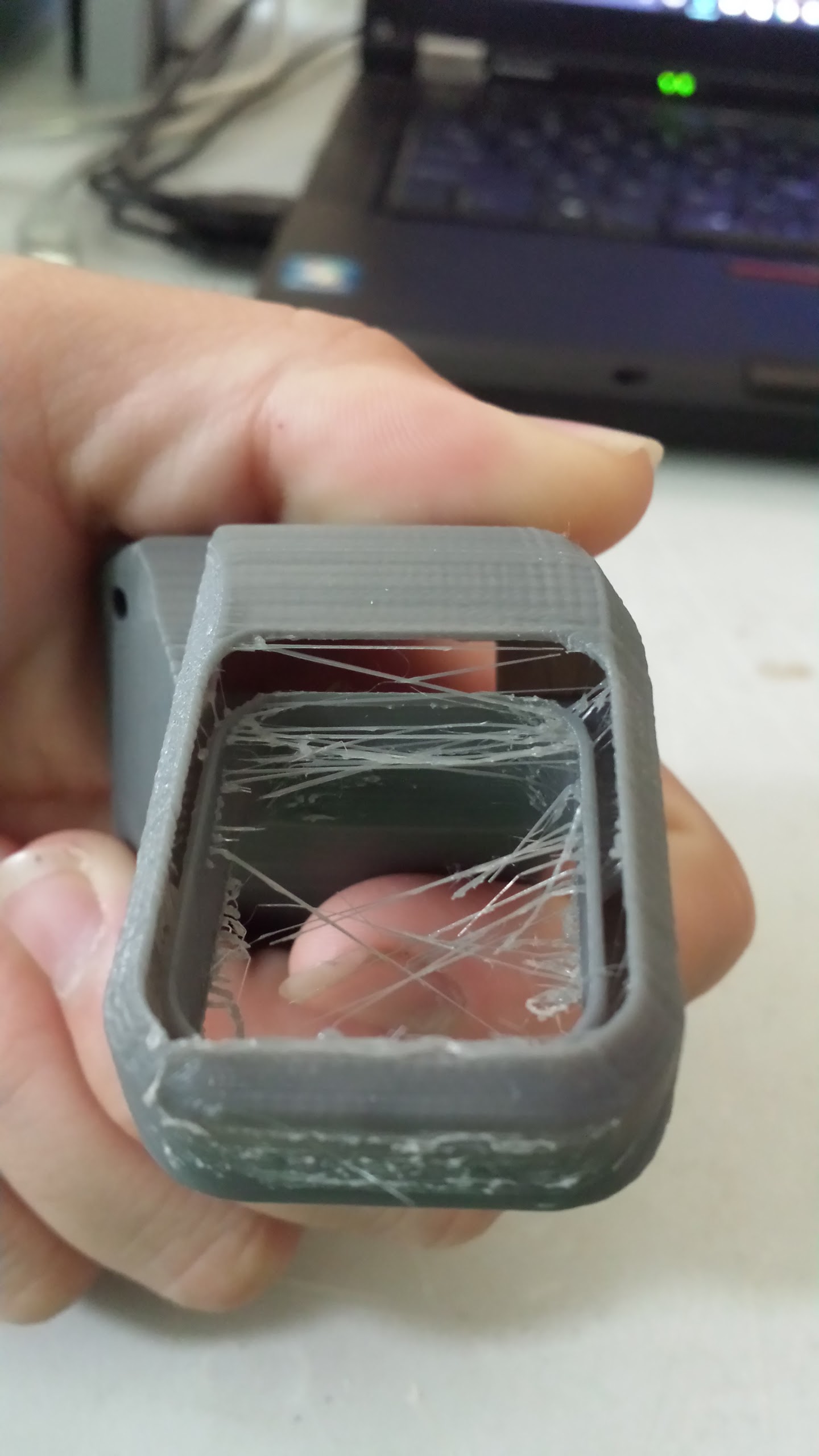

yay. thanks for all the help guys i finnaly got it to print. another question though how do i stop the strining between prints and is there a way to reduce z wobble. thanks☺
Stringing can be fixed buy increasing the retraction. Z wobble depending on your printer, you need to prevent the Z axis from “wobbling”
@Ariel_Yahni_UniKpty thanks. ya i guessed as much with the z wobble thing but thought there may have been something else. i have a printrbot simple metal do the z axis is as beefy as its going to get. how much should i increase retraction?
Retraction you need to play with, i will say increase by a 1mm and if you start seeing under extrusion in then decrease a little. By no means there is one solution to all but is a place to start. On wobble i agree no much there, hope other s can provide ideas on that
Retraction and temp.
Now that you have your temp dialed in what are your current retraction settings? I would try increasing your retraction speed a bit first and then try increasing the distance.
Other than the stringing the print surface looks quite good.

lower temp, increase retraction, increase print speed, use smaller nozzle (they wear out pretty fast) try those and you are all set.
