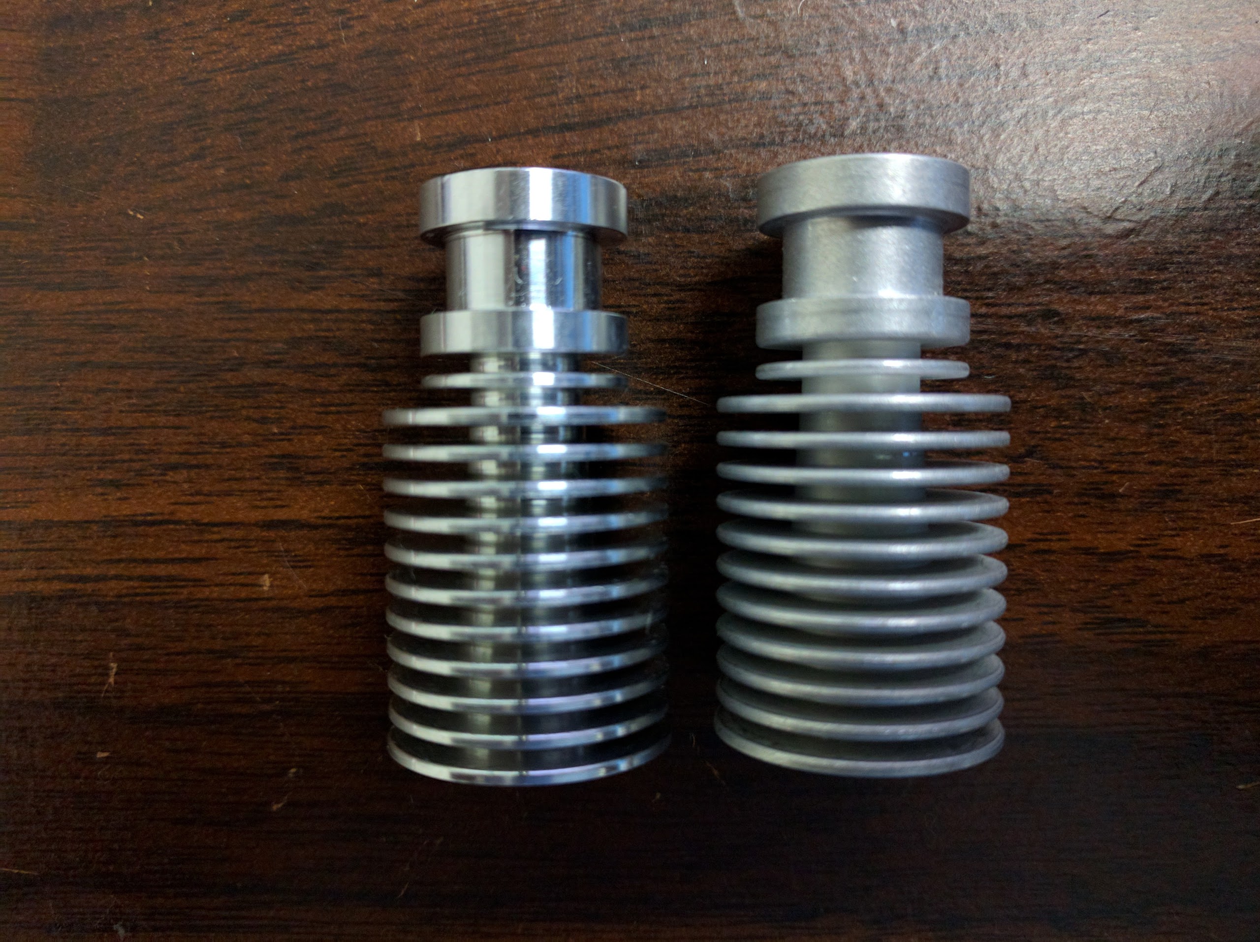

This is what I was referring to, though. Might be a little tough to see in the pictures, but the one on the right has been treated. Hoping to get some data to share, but there’s up to 4x as much surface area with this surface finish. @Whosa_whatsis

This is why? More surface-area?
Not sure I follow you… the rate of heat transfer is directly proportional to the surface area through which the heat is being conducted. If there is a significant increase in surface area - there would definitely be an increase in the rate of heat transfer - at least theoretically.
Perhaps that isn’t realized because the fan CFM fan is too low to achieve more cooling. Is that what you were getting at?
Yes, but it’s also proportional to the difference in temperature between the surface and the air moving over it. If you can’t conduct heat to the surface, you’re only cooling the surface and not the core. Likewise, if you transfer heat to one bit of air, them that same bit of air goes over another part of the surface, there will be less difference in temperature and less heat will transfer away from that part. Adding turbulence will ensure that the air is thoroughly mixed, and you won’t have areas of cold air next to areas of warmer air coming off the heatsink.
Air could get trapped in the rough anodised surface and act as an insulator.
I didn’t mean to suggest that it would increase 400%, simply that the surface area is increased by up to 4x. I’ve yet to get in front of a FLIR camera, but hope to soon. I don’t expect a big difference at temperatures below 260C (as it relates to printing performance - a few degrees C cooler may be statistically significant, but may not have any noticeable effect on the printing process), but I have a feeling there could be a not-insignificant one at higher temps.
