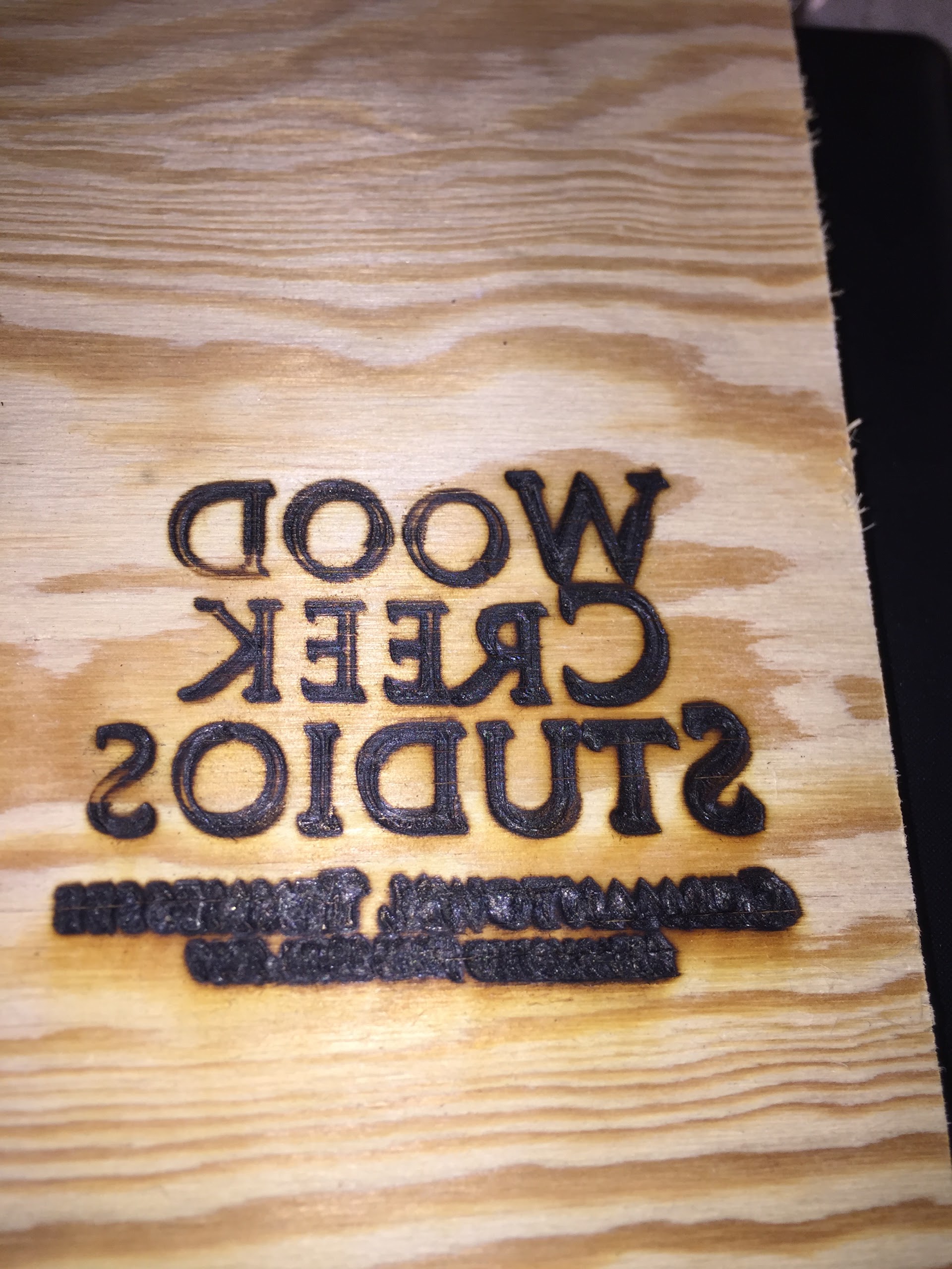

Yes it’s out of focus yes the mirrors need to be aligned and the power and speed need adjusting along with the image is mirrored for some reason but it’s my first burn!
Congrats!
Assuming you are using stock software, make sure “mirror” is unchecked in the engrave manager panel.
@Nedman I am using illustrator to make the svg and laserweb for to process and send to the laser ah and the board is cohesion mini
You may have the X or y axis connector upside down, if it’s okay in the software.
Does it jog in the correct direction in laserweb?

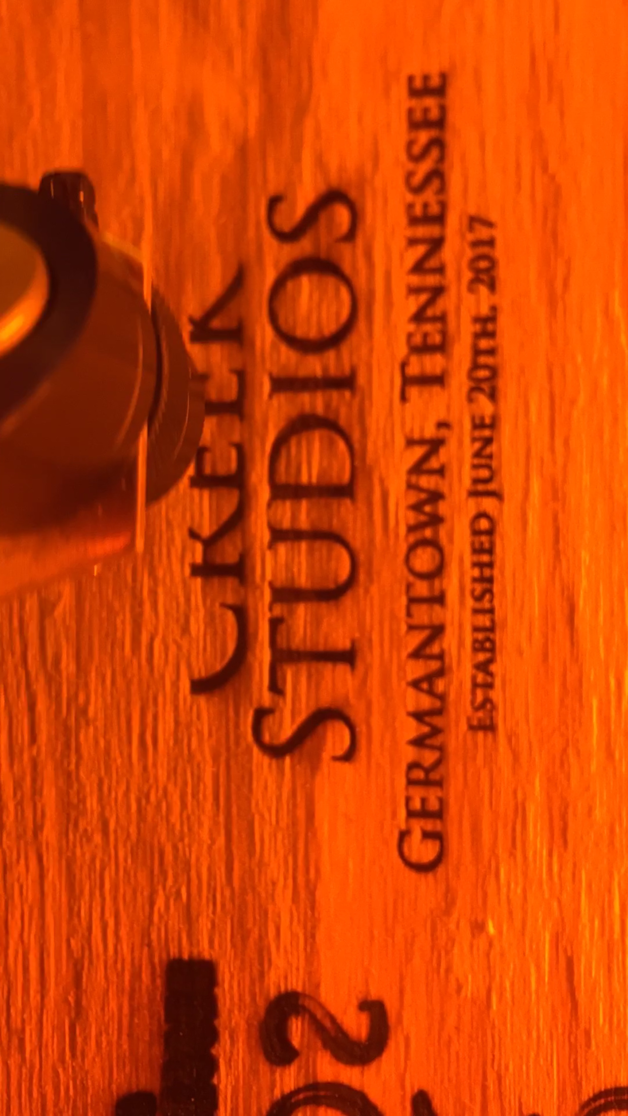

After I turned them upside down they did but I have to move all my files to the negative y in order for them to print with a positive image
