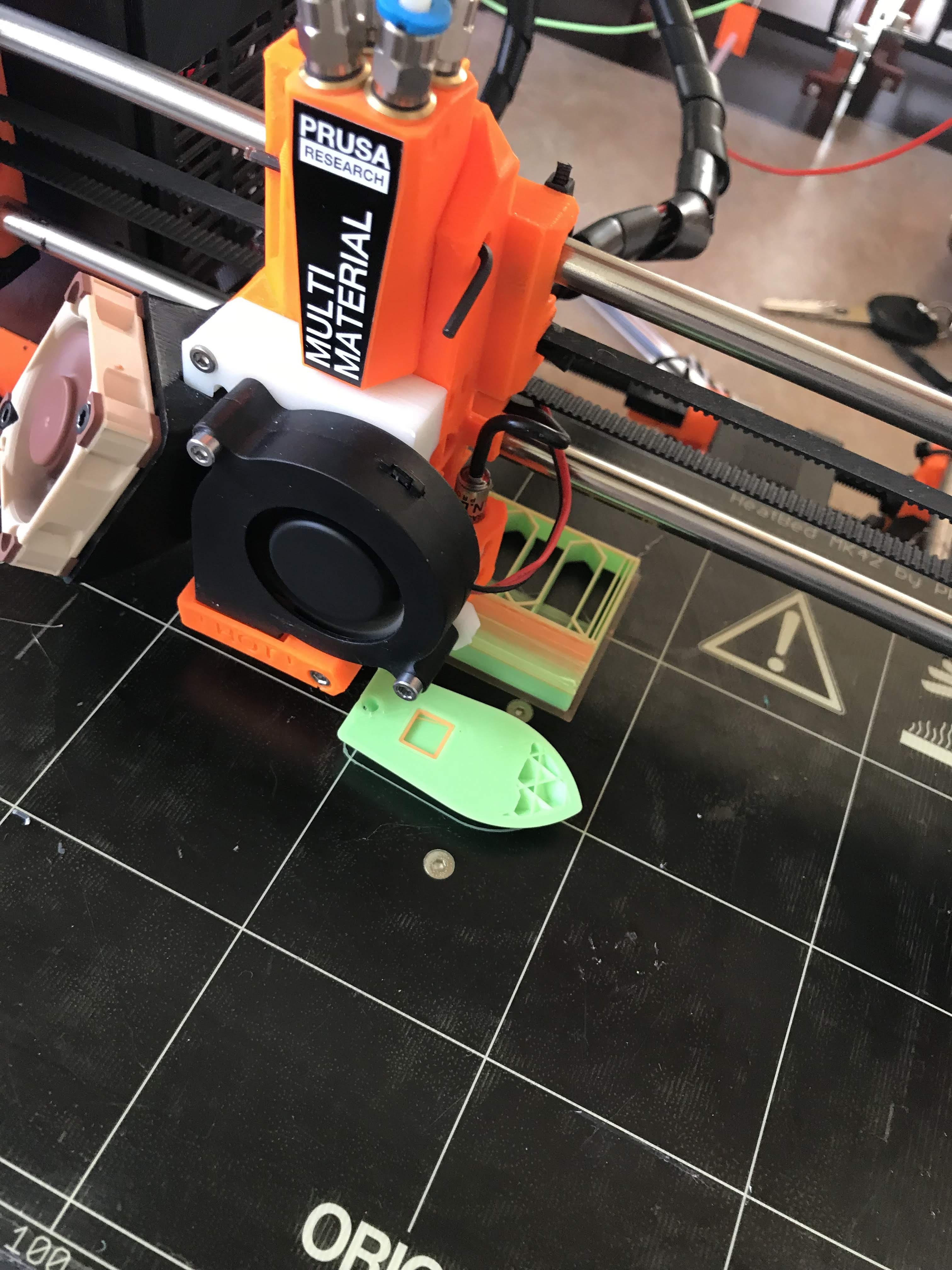

YES! I've been pulling my hair out trying to get PLA to work with
YES! I’ve been pulling my hair out trying to get PLA to work with the MM kit, this little color change (many many layers into the print) is the best looking thing ever!
(Ridge in heat break needed to be polished, Nozzle seasoned with canola, firmware updated, and the Benchy had to be run through the lates Slic3r, rather than using the factory provided g-code)
https://plus.google.com/photos/… all four filaments successfully changed!

This is the e3d included in the MM kit, it’s not 100% what the average e3d includes. The heat break is a little different, and it’s got a 41mm ptfe piece to help guide material from each tool path.
