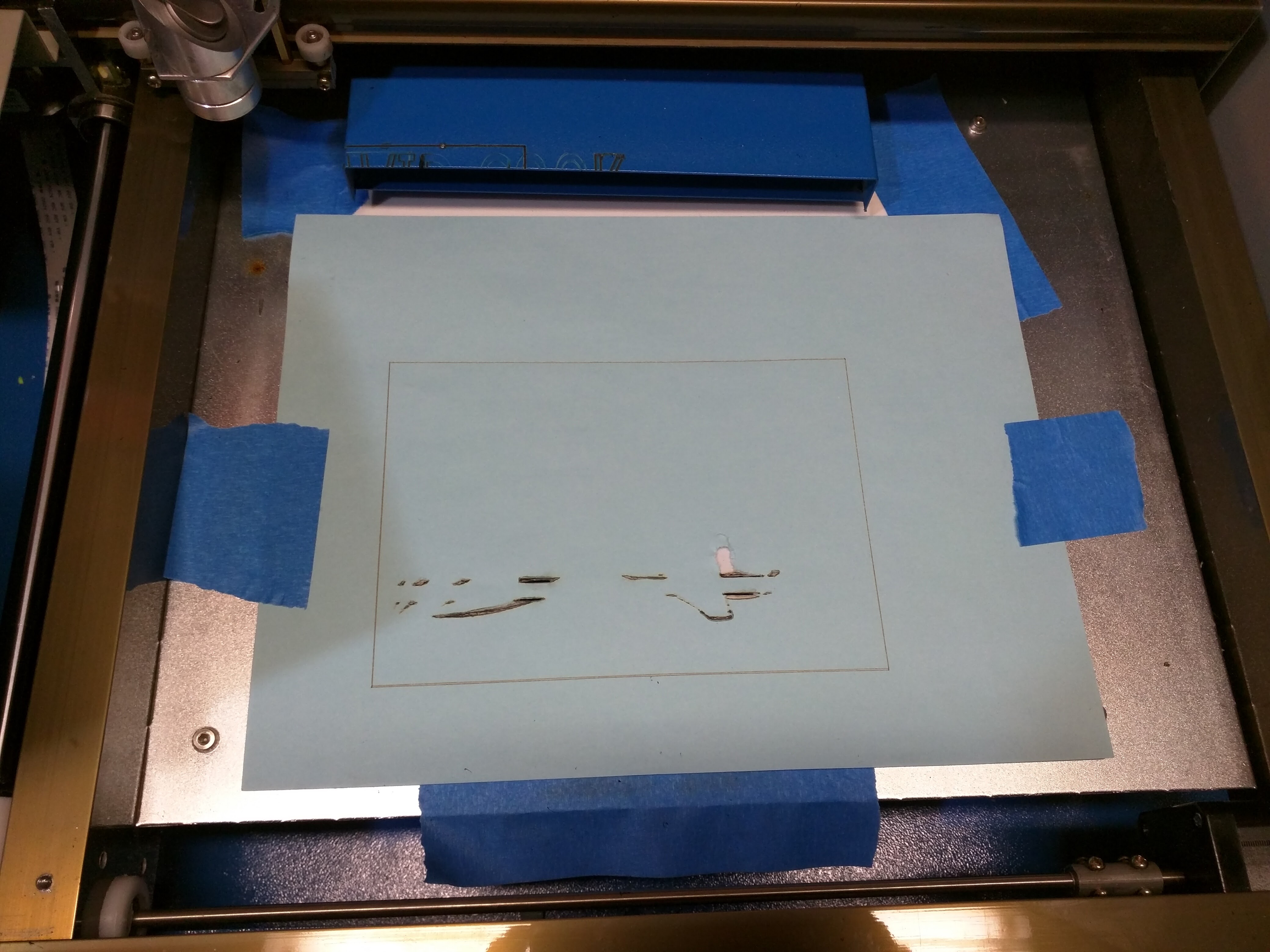

Yes!!! My first real engraving.
Yes!!! My first real engraving. Did both sides of my wife’s Kindle leather case for her birthday. Raster on front and vector on the rear. So cool. I want to mark and etch alll my stuff now lol.
12% power of 90% limited max
3,500mm/m
30PPM
TurnkeyTyranny Inkscape plugin.
I put a piece of paper down and drew an outline of the kindle case at 10% power to help align the case. Worked good
Thank you everyone in this group for all the help in getting me to this point. I think I am still under the $700 mark all in on this machine. It’s working great .
Engraving leather smells like burning people! Lol
