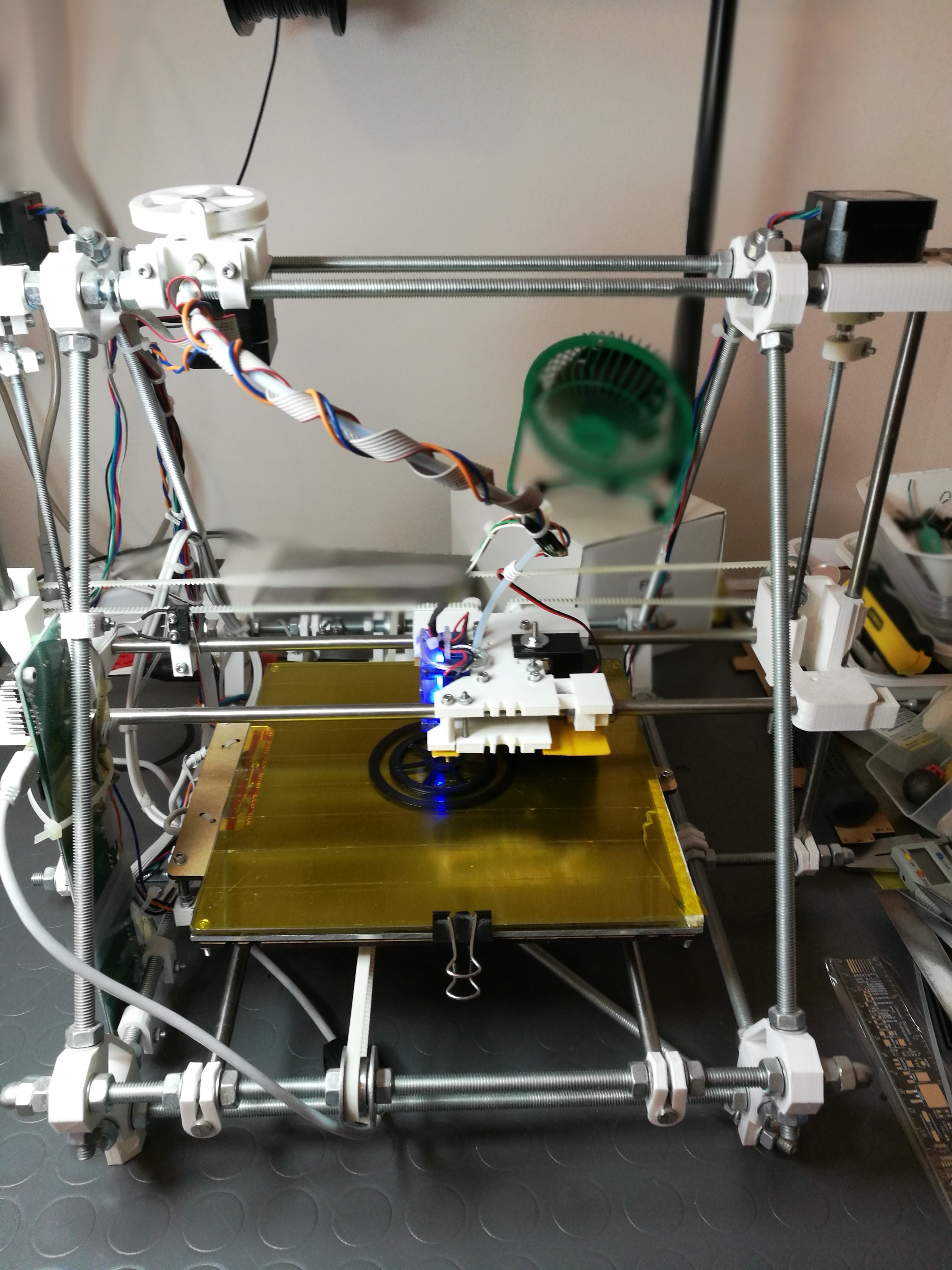

Yesterday I decided to improve my old RepRapPro Mendel, and I found a clever way to easily block a digital calliper on all the three axes, and then I started to carefully calibrate the axes steps.
Now I am printing the first objects after years of dust. They look very nice.
Then I think I will try to recalibrate the objects fitting capabilities.

Now I changed to the following configuration:
A - One glass with Blue tape (only on cold plate)
B - One glass with hair spary (only for hot plate)
Now I am printing PLA only.
I am testing the A glass, with very good results. Often I need to remove (unclip) the glass from the bed in order to detach the prints, to avoid to damage the printer due to the force I need to apply to detach the objects.
I still need to test the B configuration and evaluate what is best.
If you print on tape, the bottom of your print won’t be smooth. With hairspray you even get a extra smooth coating. Keep us posted on your findings!
@Mano_Biletsky_Open_M You are right. I have already noticed, that comparing the bottom layer of objects printed on scotch with the bottom layer printed on kapton, there is a significant difference.
