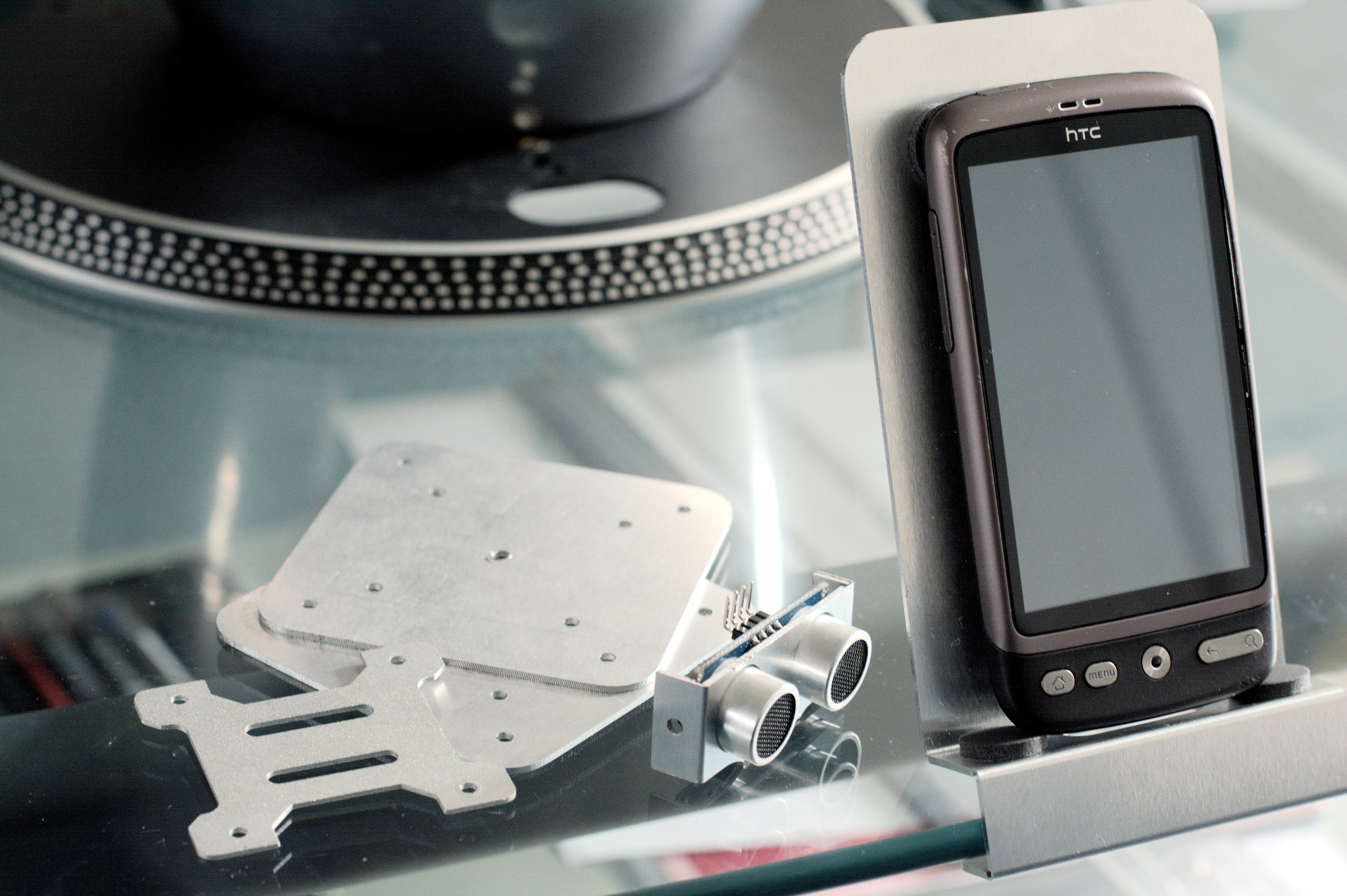

yesterday I milled my first aluminum parts - a phoneholder and a sensorhead (for
yesterday I milled my first aluminum parts - a phoneholder and a sensorhead (for a robotic project) with my machine. The result is repeatable good. Milled it with a two blade / 3mm / fishtail proalu in 1.5mm aluminum. I can produce my own machineparts now - yippie!
That looks really nice!
Excellent, keep it up,all the best for the coming projects
How did you bend it ?
@Paride_Zavoli I have bent it on a steel corner, glued on a piece of wood. 1.5mm is easy to bent by hand. There is a cut on the backside.
