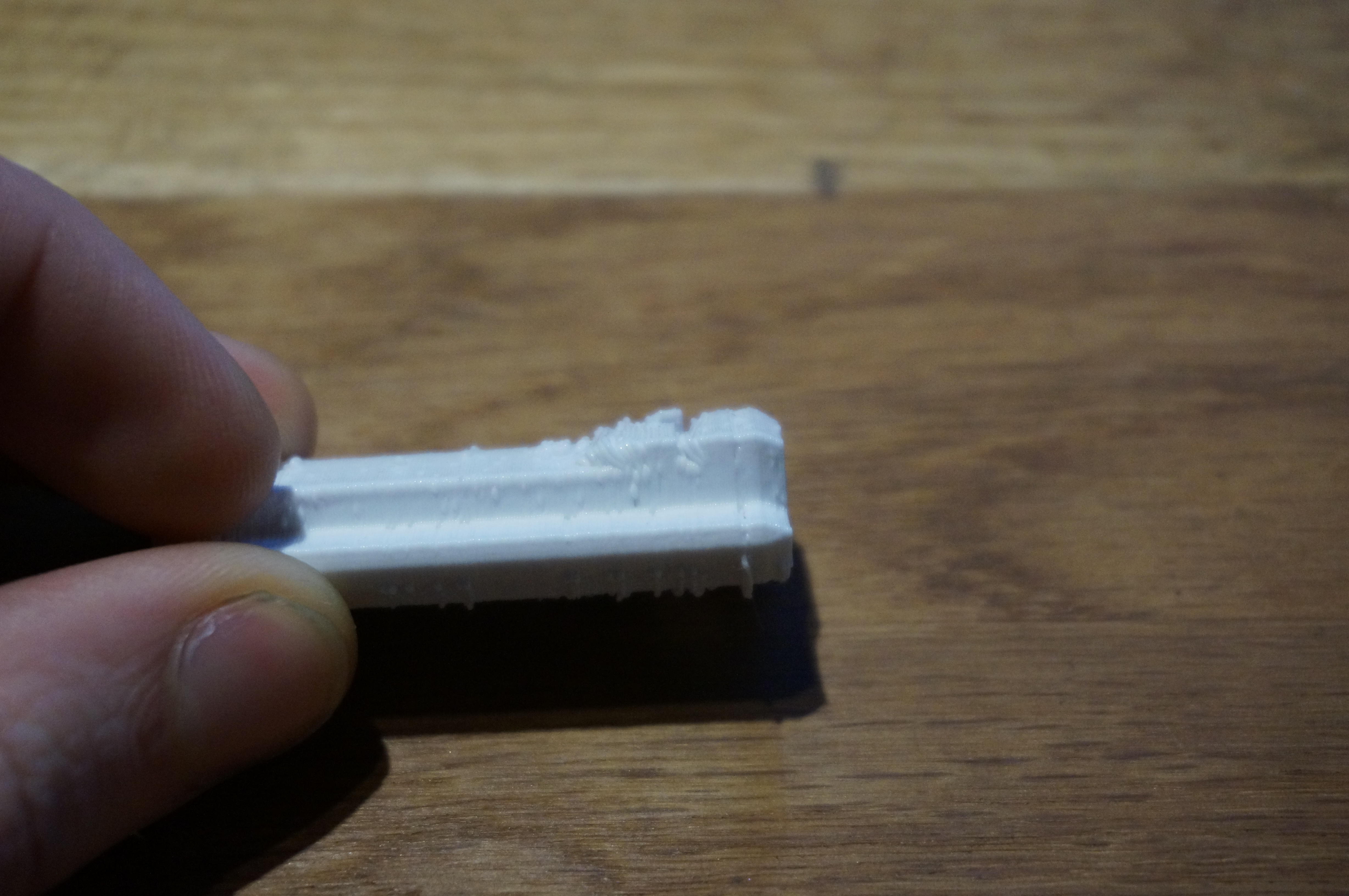

I turned up the stepper current and everything works now. Seems like the printer was symmetrically missing steps, It skipped the same amount of steps in one direction as the other.
This picture is shows how it was printing before, looks like the part is supposed to look like that since the skipped step is only on one part of the print, very strange.
Is this a case of it printing and then every now and then just stops moving for a second or so and then continues printing?
@Pieter_Koorts No it looked like it was correcting itself.
