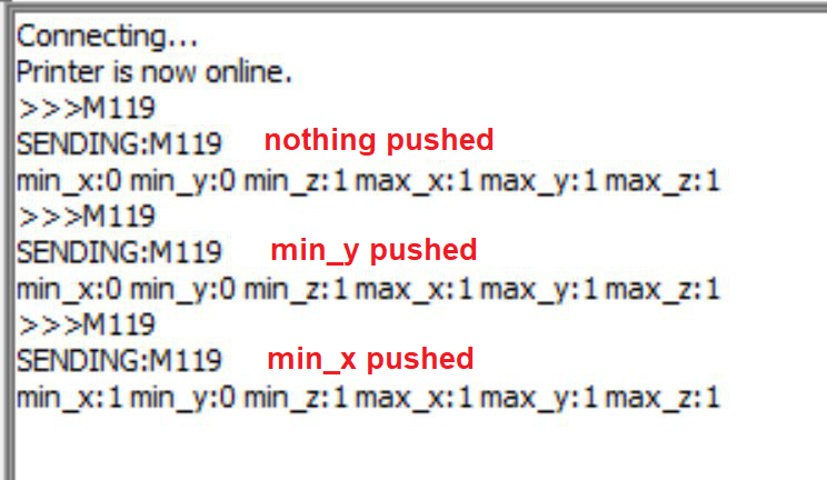

The problem is that Y min limit switch is not working. It means that when I use Pronterface to home in Y, the motors are spinning properly, then either the aluminium profile or my finger press the limit switch and it does not stop the motors.
The X axis it working fine (homing OK, switch OK) and I wired the Y min limit switch the same way. I also tested it with a multi-meter. I also used the M119 command to test the switches. I think it’s a wiring/board problem…
Enclosed there is the pic of the wiring, the config file and the M119 result (I am a new user, I cannot put all of that)

Change the pin assignment to use the Y Max port for your Y Min switch. (pretty much swap 1.26 and 1.27 with each other. See if that is a viable workaround.
This is a very good workardoung thank you !
M119 shows the switch now works. But this mean the board is somewhat faulty isn’t it ?
