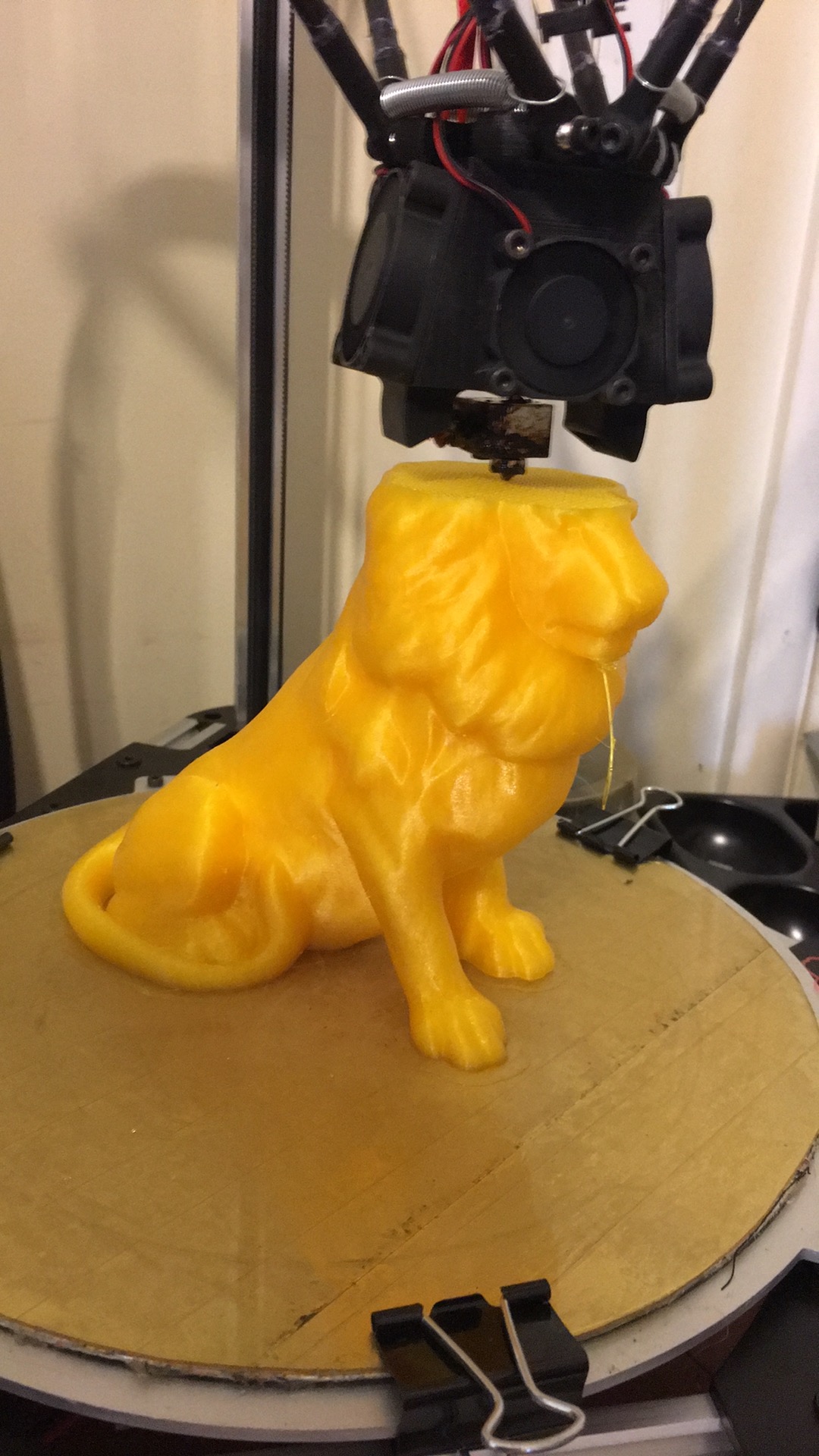

Yo MGM, I’m really happy for you, Imma gonna let you finish, but my PETG lion is the best lion of all time, the best lion of all time!
Printed by Trisha (my Tria Delta). Yellow eSun PETG, printed at 75mm/s.

Your Lion is drooling. Get that boy a wetnap

@Alex_Lee nice, and on a Delta too, what do you think of it vs Cartesian printers?
@Tony_Gomes Deltas are a pain to get the geometry right, but once you’re over that hurdle, they absolutely awesome to print with. In quality and speed!
@Alex_Lee , awesome PETG lion print!
What slicer did you use?
Inner & outer perimeter speed?
Head temp?
Thank you : )
@Ivan_Hoe Thanks! I should have shared that information too, sorry.
This is using Simplify3D.
Print speeds at:
Infill: 75 mm/s
Perimeters: 40%
and 255C Nozzle and 70C Heated bed
