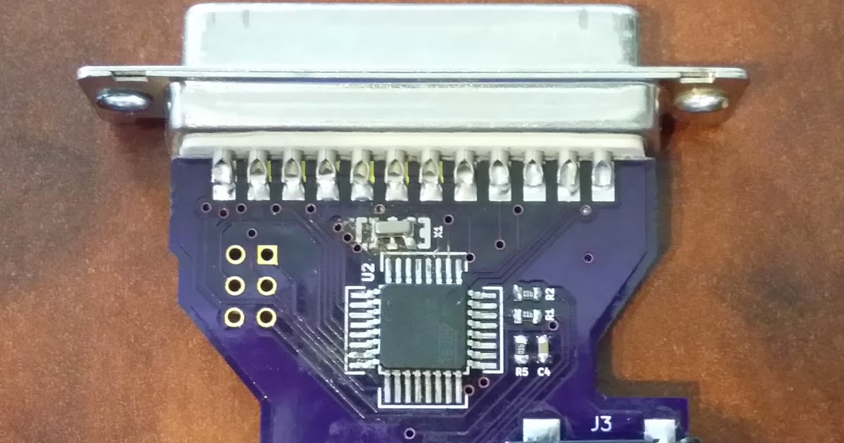

Well… I ended up the day by wiring a $5 Nano directly on a DB25! Super ugly but so minimalist that I like it nonetheless. Seriously: it works extremely well… and I can now pause even within a move thanks to GRBL 1.1, wow!
(detailed in two chapters I appended to my post)
LOVE the nano<>db25 hack! Make a box with integrated usb, like scart plug
@Jorge_Robles eh, I just stumbled upon this (I did not find the full sources, but the idea is there & the trivial schematic is provided in PDF). Lovely!
