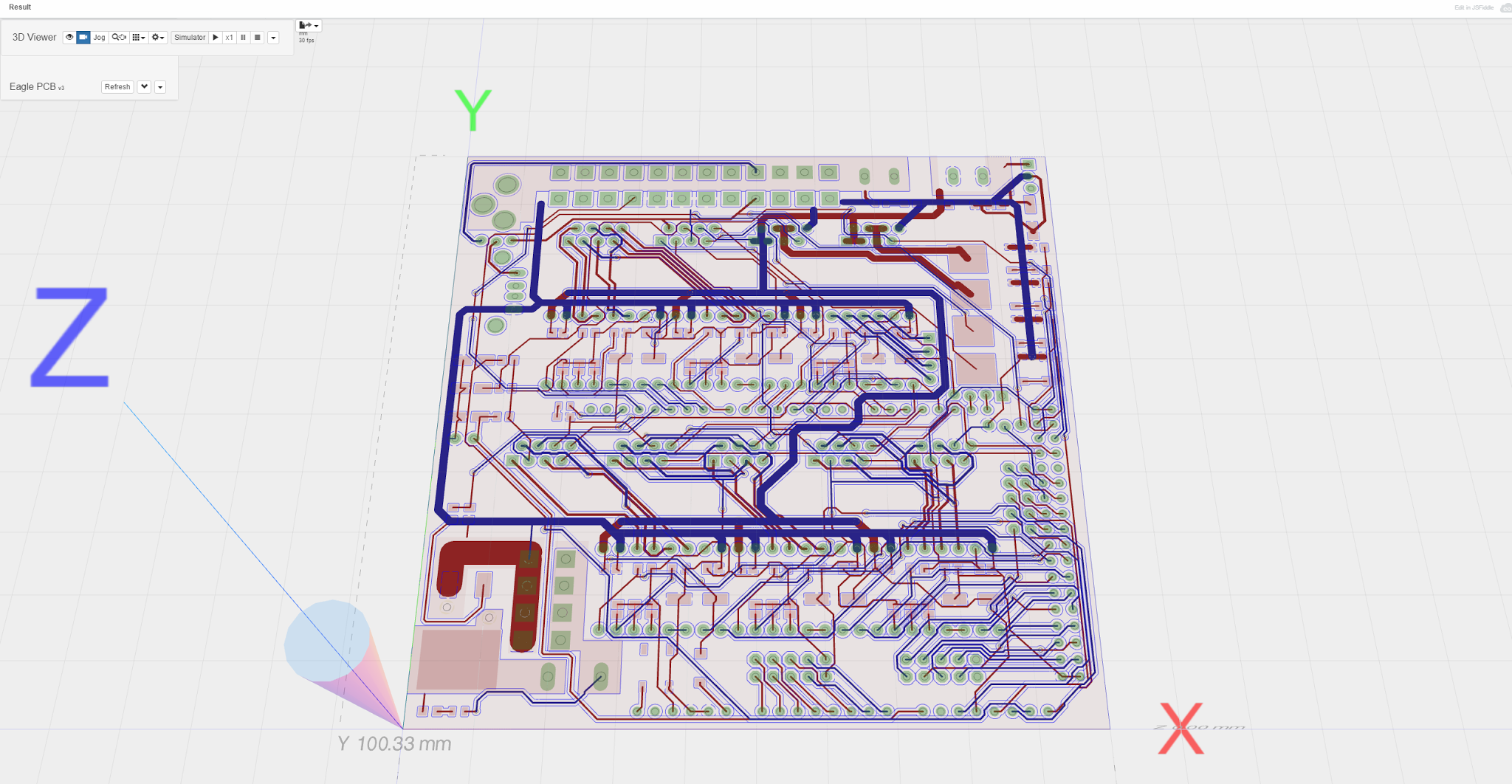

You can now render 2 sided boards in ChiliPeppr’s Eagle Brd Import Widget. It’s not functional, as in you’re not going to get gcode output for multi-sided milling, but it’s a good first step, really cool to look at, and helps me visualize my PCB designs in a 3d (not flat!) way.

@jlauer and I made a substantial amount of progress today on tapping into the board info after it gets parsed. This means there is a json array of every single wire, part, polygon, smd pad, and just about all other elements on your eagle board available, but we’re just interested in the ones I listed. All boards have layers 1-16 defined even if you never made them yourself so our approach for finding “actionable” layers is to loop through every single piece of copper and check off which layers #'s they are on, then push the corresponding layer names into the selection dropdown. From there, whenever you select a layer, that is what gets rendered and gcode generated for it.

Nice work. IMHO the next step maybe are a checkbox or selectbox to render only top/bottom. I try your jsfiddle example with an arduino smd micro and the levels are more confusing
Maybe we can display the oppoisite (Bottom) Side on a Level at -1.6mm (Thick of pcb)?
@Frank_Herrmann That’s what we’ve been working on for the last few days. Try it out:
http://jsfiddle.net/raykholo/oxkcvrn3/23/
